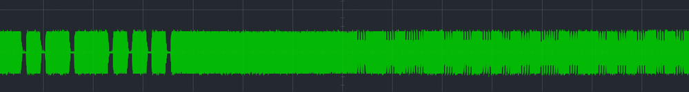

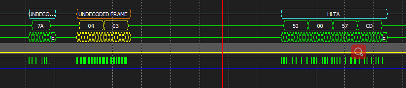

I want to emulation the non-standard NFC protocol (not T3T, not T4T). only use The AFE of ST25R3916 to send and receive data;
just like this:
0693W000006FPqLQAW.pngIs there an example like this this I can refer to

I wanted to simulate slave cards using ST25R3916: most of the commands are standard ISO14443-A, but interspersed with non-standard commands
