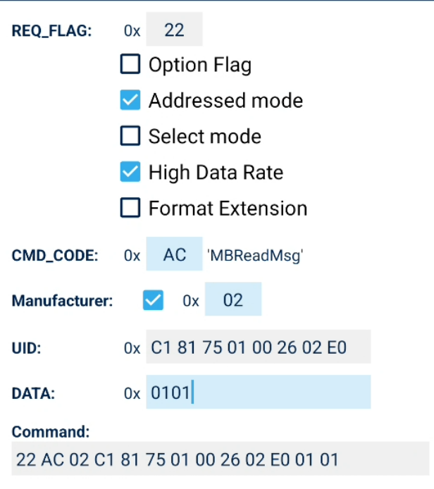

I thought I could send custom commands to the ST25DV Tag by using the NFC Tap app. Is that possible?
In the app there are two fields when I chose "Custom":
1) Custom Command. There I enter "AC", to Read Message (mailbox).
2) Data: what to enter here?
Can someone explain how to use it? I send some bytes to the mailbox by i2C and now I want to use the app (NFC Tap) to read these bytes.
Navigation inside the app: "NFC Tap" -> "CoreNFC" -> "Custom"

France Berthelot
Hello
You have to build the command according to the Databrief, to simplify, you have to use and setup following parameters:
Request parameters:
• Request flag
• UID (Optional)
• Pointer (start at 00h)
• Number of bytes is one less then the requested data
Please refers to datasheet on st.com for parameters details
ST25DV16KC - Dynamic NFC/RFID tag IC with 16-Kbit EEPROM, and fast transfer mode capability - STMicroelectronics page 123 for exemple.
Before reading the message, you probably need to know how many bytes are available, you can use Read message Length command ...
For exemple, the following custom cmd, read mailbox, if a message has previously been posted...
_legacyfs_online_stmicro_images_0693W00000bhsOfQAI.pngHope this will help, building customs cmds.
BR, FB

France Berthelot
Hello
Android apps, but you are working with the iOS one, you should probably have a menu just before CoreNFC one with Custom Commands which is similar to the android one.
Nevertheless, it is the same way of doing you should provide correct full command data applicable to the context and command description provided in the Datasheet.
BR,FB

... just tried command 0xAA to write a message. Its working.
Command: AA
Data: 010908 (01 = 2 bytes; first byte 09 and second byte 08).
Any hint why the read command doesn't work?
Command: AC
Data: 0000 (MBpointer to 00 and Number of Bytes to 00 -> MB_LEN bytes should be returned)
Feedback: custom : OK
I was expecting to see the 4 bytes I placed by i2C to the tag but instead I get the feedback: custom : OK what does that mean?

JDirk.1
Senior
I checked it out and it is working fine! Many thanks for your quick support. It helps a lot to use the ST25DV tag in my future products.
