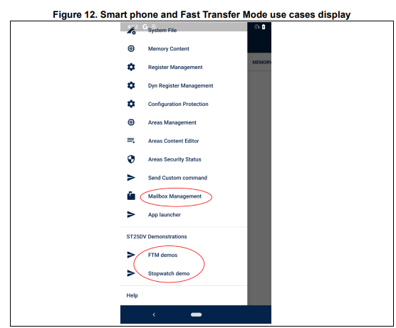

oziesin
I guess, i could not explain myself. For example assume that i use android and i opened the application.I faced this screen( figure 1).
I do not use any development kits therefore I do not click FTM demos and Stopwatch demo section.

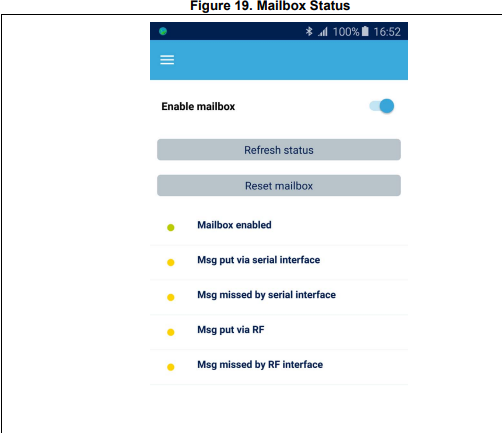

I clicked Mailbox Management section and i faced this screen (figure 2).
There is no section for read the data inside the mailbox . That's the problem.
How can i read the datas which wrote by mcu inside the mailbox ?
I hope i could explain clearly. Thank you for your all helps .
Olivier L
Hi Oziesin,
In the Android application, it is not possible to read the raw content of the FTM mailbox.
Are you able to compile an Android application? If yes, I can indicate you how to proceed to read the FTM mailbox. You will have to download the source of our android app (here: https://www.st.com/en/embedded-software/stsw-st25001.html)
Then I will be able to point you a file that you can modify to read the mailbox.
Tell me if it is ok to proceed this way.
Regards
Olivier
