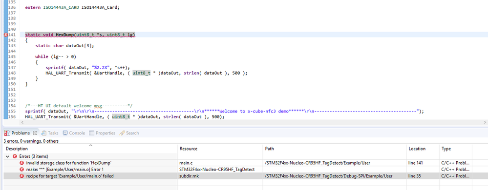

ADist
Error..:confounded_face: 0690X000006Dt1JQAS.png
Brian TIDAL
here is the modified main.c file (in C language, your modification are not valid).
Rgds
BT
