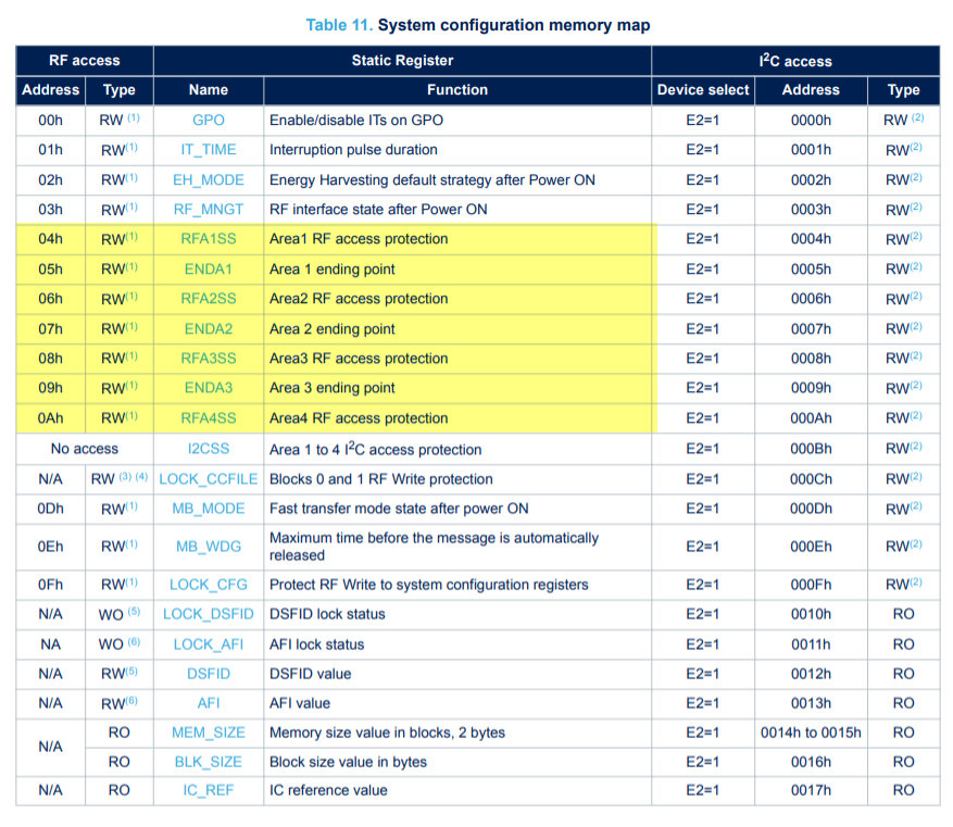

I have a question for the configuration of the static registers via the I2C bus.
The easiest way to configure the Area RF protection and Area ending point registers, (address 0x0004 until 0x000A), is to send a I2C write message to program all 7 data bytes in one I2
See the table 11 snapshot from the datasheet:
However, data is not programmed. Any suggestion why it does not work?
NOTE: This question and answer originated from a customer support case which was handled by us. We regularly review support cases and add any helpful ones here for all to benefit from.
Central SUPPORT
Senior II
In fact, configuration registers must be programmed byte-by-byte in separate I2C Write Byte command messages.
We recommend to
·       first set the area limit registers (ENDA1, ENDA2, ENDA3) and
·       then set RF security status registers (RFAnSS).
