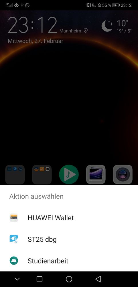

Hi, I´m doing a project in which I have to programm an android app which shall write and read the mailbox. Using the ST25DV Demo app I figured out, how to read and write the Mailbox. A nice feature of the app should be, that I can read the tag and choos between various apps which can handle the technology.
What I want is: I read the Tag, then there is a android dialoge which shows my app that I can choose to open.
My Android-Manifest contains following code:
<intent-filter>
<action android:name="android.intent.action.MAIN" />
<category android:name="android.intent.category.LAUNCHER" />
</intent-filter>
<intent-filter>
<action android:name="android.nfc.action.TECH_DISCOVERED" />
<category android:name="android.intent.category.DEFAULT"/>
<data android:mimeType="text/plain" />
</intent-filter>
<intent-filter>
<action android:name="android.nfc.action.NDEF_DISCOVERED" />
</intent-filter>
<meta-data
android:resource="@xml/nfc_tech_filter" />
In the "nfc_tech_filter" I added the techlists like in the ST25DV demo app:
<?xml version="1.0" encoding="utf-8"?>
<resources xmlns:xliff="urn:oasis:names:tc:xliff:document:1.2">
<!-- capture all ISO14443A tags (NFC tags Type 4)-->
<tech-list>
<tech>android.nfc.tech.NfcA</tech>
<tech>android.nfc.tech.IsoDep</tech>
<tech>android.nfc.tech.Ndef</tech>
</tech-list>
<!-- capture all ISO15693 tags -->
<tech-list>
<tech>android.nfc.tech.NfcV</tech>
</tech-list>
<tech-list>
<tech>android.nfc.tech.NdefFormatable</tech>
</tech-list>
<tech-list>
</tech-list>
<tech-list>
</tech-list>
<!-- capture all ISO14443B tags tags -->
<tech-list>
<tech>android.nfc.tech.NfcB</tech>
</tech-list>
</resources>
If I scan my debit card, I can choose between various apps that I can start, including my own app. If I scan the St25DV, there is just the Dialog to choose between Google Play Store and Huawei App Galery.
I hope you understand my problem and have an advice or a solution.

michel_hoehn
March 1, 2019
Hi Olivier,
I used the AAR Record to launch my program, yes.
I want to start my android application everytime a ST25DV04K is tapped.
The image below shows the thing I want. With my smartphone i come closer to the ST25DV04K and if it is recognized by my smartphone I want to be asked which app I want to use. My App here is called "Studienarbeit". The code above works with my own debit card and some others but not with the ST25DV04K.0690X000006Dw2IQAS.jpg
Thank you for your efforts. I hope you got what I mean. I'm quite new to NFC and programming android application. Please excuse this.
Regards
Michel
Olivier L
March 1, 2019
No problem Michel, that’s the role of this forum to answer to questions.
You have problems to launch your own Android App through NFC Intents. This is maybe due to your NFC Intent Filters that could be wrong. To know if that's the case, I propose you an intermediate test:
I can see on your image that you have our ST25 NFC Tap application installed. Please launch it and program your tag with an AAR record indicating to launch our application. Leave the application and check if it gets opened when you tap the ST25DV tag. On my side it is working.
BTW, if it works, you will see that the ST25 NFC Tap application will be opened but you will have to tap the tag again to get some information about it displayed. To change this behavior, you can add a URI record (the URI doesn't matter. I have used www.st.com) and then add a AAR record (it should be in second position).
Do the test and this time, the ST25 NFC Tap should be opened and display informations about the tag.
Regards
Olivier
