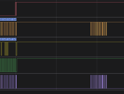

@RMuiz.1 wrote:
What confuses me is why Intr jumps back high when I start reading interrupt registers
See  § "Interrupt interface" in the ST25R3911B datasheet: [...]IRQ pin transitions to low after the interrupt bit(s) that caused its transition to high has (have) been read.
It is likely that a second interrupt is signalled while reading the second interrutp register (likely I_rxe interrupt).
Make sure to configure the Salae SPI decoder with CPOL=0 and CPHA=1 to properly decode the SPI frames. The SPI CS handling seems to be erroneous (except if another devices are connected to the SPI bus):
The SPI clock seems to be quite low (300 kHz). Our demos use a SPI clock = 3Mbps.
Rgds
BT

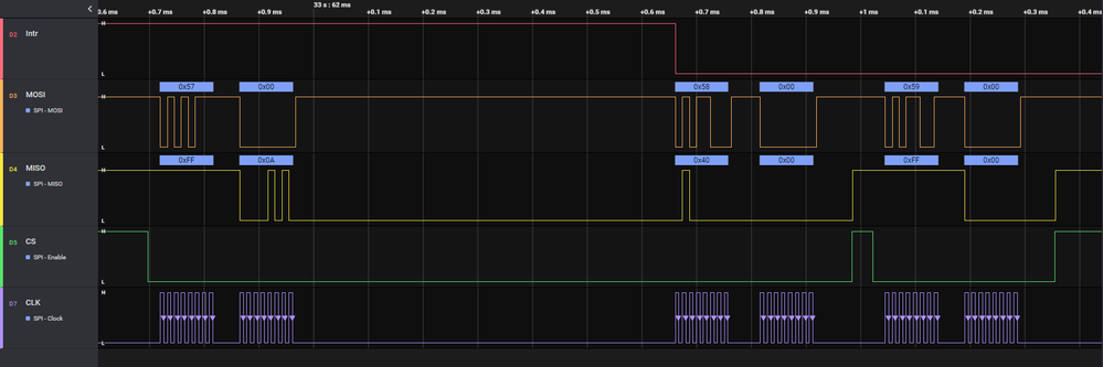

Attached ErrorCapture.hex (Real extension ErrorCapture.sal) Capture made using https://www.saleae.com/downloads/
https://drive.google.com/file/d/1HP3trKfch0tgLm-TP4rdvEN691bfpKf_/view?usp=sharing
Error happens before 50 ms gap
two issues seen here:
  1. CS is incorrectly driven here - does not go high between two read register commands. I assume your driver will not use the 0x40 on MISO as I_nre and thus driver signals IOError.Incorrect_driving_of_CS.png
  2. All Interrupt status registers need to be read within one SPI frame (DS: "The interrupt registers 0x17, 0x18 and 0x19 are to be read in one attempt.".) Single read registers will also cry out for problems. None of that seen here.
Which code base was the basis for this Rust driver? Must be quite old as the single interrupt reading is not recommended for quite some years (even before ams->ST transfer).
Best Regards, Ulysses
Ohh never noticed that CS behavior. That explains a lot :) Will investigate and post an update of what happened here.
I thought reading multiple registers in one attempt is just optimization and reading multiple times would be fine. What kind of problems it can cause?
