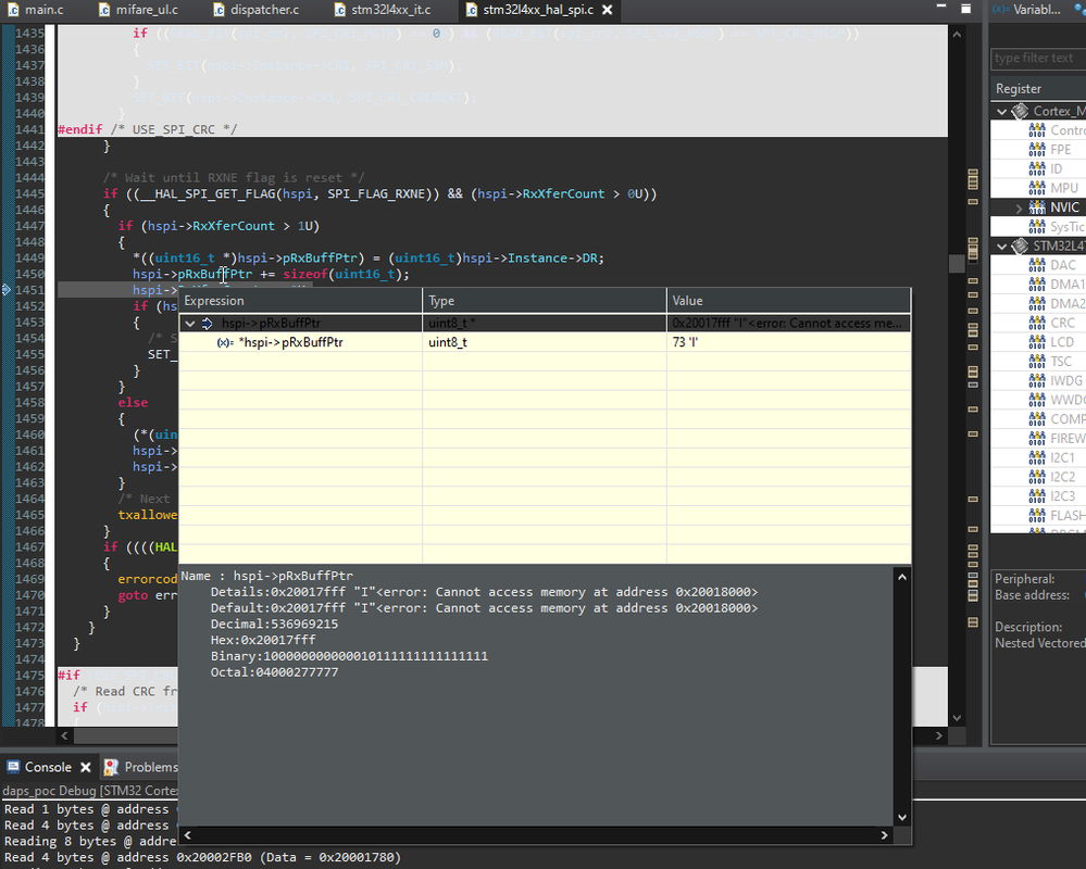

When I leave my code to play for more than one hour I received the error HardFault_Handler(), I found in registers whats the last line executed before entering in the error function, below I put a picture of this part of the code. 0693W00000AMXbnQAH.png
Note: That error is random, don't have a specific moment time when happens.

hpsi->pRxBuffPtr is at @0x20017fff which is the end of STM32L476 internal SRAM1 area. Access to next byte (@0x20018000) will cause a fault...
it looks like a HAL_SPI_TransmitReceive call with an incorrect/corrupted length parameter...
Rgds
BT
Is the buffer on the stack or heap?
Looks to be blowing the buffer's scope, add some better sanity checking in your code.
Watch for stack/heap overflow, or resource leaks within your implementation.
Remember callbacks are done under interrupt context, and there is likely a lot of non thread-safe code, or other things that are ill-considered.

I resolve the problem increase de size of my buffer then received information by tag.

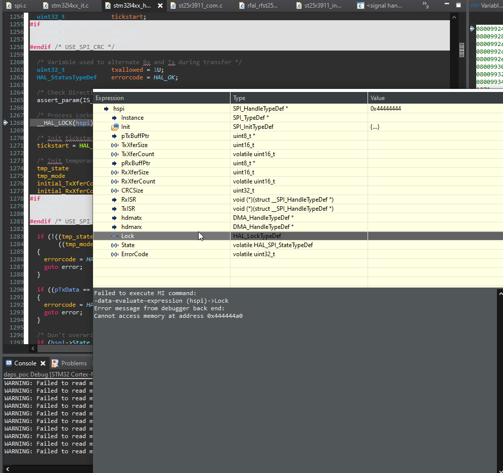

But now I had a new problem, below has a print of my new problem.

hspi pointer seems to be corrupted (value 0x44444444: it looks like a buffer overflow has corrupted this pointer....).
I would recommend to check buffers size.
