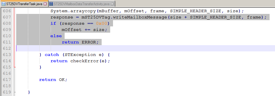

I'm trying to use the mailbox of the ST25DV64K on an android application.
The Fast Read is ok. But the Fast Write is crashing with an exception.... And the mailbox is correctly written...
When I execute the function "mNfcTag.FastWriteMailboxMessage(Msg.Count, Msg.ToArray());" , An excption is generated with the code "CMD_FAILED" and the Error Data is "0x03".
On the debugger output, I have following lines :
Send fastWriteMsg command: 22 ca 02 bb 5b 3a 0f 00 26 02 e0 1b 2c 30 2c 31 32 2c 32 30 35 2c 30 2c 30 2c 30 2c 30 2c 30 2c 30 2c 35 34 31 31 34 2c
Response: 03
On the ST25DV, the mailbox has received the message, and the RF OUT flag is set.
What is the problem ?

Your first request refers to mailbox using fastCommands..... "Send fastWriteMsg command: 22 ca 02 bb 5b 3a 0f 00 ...."
The writeMailboxMessage of the file in snapshot extracted from ST25AndroidApp use standard command and not fast, fast command are only supported by some readers, android do not support fast commands.
The FastTransferTask class use a mST25DVTag object implementing FastTransferModeInterface with following methods:
   public byte writeMailboxMessage(byte[] buffer) throws STException;
   public byte writeMailboxMessage(int size, byte[] buffer) throws STException;
   public byte writeMailboxMessage(int size, byte[] buffer, byte flag) throws STException;
   public byte[] readMailboxMessage(int mbAddress, int size) throws STException;
   public byte[] readMailboxMessage(int mbAddress, int size, byte flag) throws STException;
   public int readMailboxMessageLength() throws STException;
   public byte fastWriteMailboxMessage(byte[] buffer) throws STException;
   public byte fastWriteMailboxMessage(int size, byte[] buffer) throws STException;
   public byte fastWriteMailboxMessage(int size, byte[] buffer, byte flag) throws STException;
   public byte[] fastReadMailboxMessage(int mbAddress, int size) throws STException;
   public byte[] fastReadMailboxMessage(int mbAddress, int size, byte flag) throws STException;
   public int fastReadMailboxMessageLength() throws STException;
Use only the first part and not fastxxxx methods. fastxxxx methods are not usable with android phone readers. Refers to DataSheet for Normal and fast command code.
Normal command use :
* STMicroelectronics ISO15693 Write MailBox Message custom command code for Mailbox enabled series
public static final byte ISO15693_CUSTOM_ST_CMD_MB_WRITE_MSG = (byte) 0xAA;
Fast command use : (the one you use.....)
* STMicroelectronics ISO15693 Fast Write MailBox Message custom command code for Mailbox enabled series
public static final byte ISO15693_CUSTOM_ST_CMD_MB_FAST_WRITE_MSG = (byte) 0xCA;
Summary: (in android environment use only following method, not the fast ones)
I hope this answer clarify the point.
Regards,FB

xNiux
But in the ST25AndroidApp from ST, the command is running correctly :
Regards,FB
xNiux
You're right ! I have mixed MailBox and Fast Write !
I thought the MailBox was the same thing as the FastWrite... Now, the MailBox is functionnal ! Thanks for your help.
