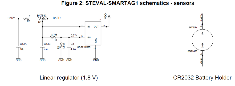

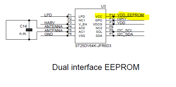

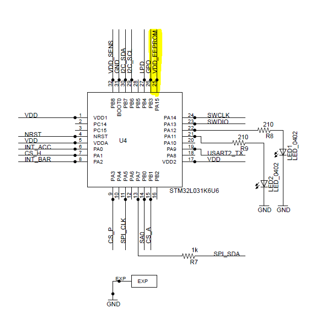

According to the datasheet - but I'd like to confirm with you -
To use FTM mode - VCC_ON must be 1 indicating VCC supply is present and Low Power Down mode is not forced (LPD is low)
I'm using the SMARTAG1 in passive (EH) mode - I.E. no battery.
The STEVAL-SMARTAG1 is using the STLQ015M18R linear regulator to provide VCC from either HARV or Batt
Which is then fed into the ST25DV VCC FROM PA15 of the STM32L0
Am I correct in assuming that if I drive PA15 high - this will provide the VCC required to set VCC_ON and satisfy the requirements to use the FTM in battery less mode?
Thank you!
