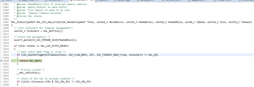

I've gone through the debugging, and it appears to fails in the BSP_I2C1_ReadReg16() function. It returns BSP_ERROR_PERIPH_FAILURE, so it seems its the I2C failing after the board loses power.
I have tried using DeInit functions for the tag and for I2C. I reinitialise the I2C, which returns without error, but when trying to reinitialise the tag it fails at the same function with the error BSP_ERROR_PERIPH_FAILURE. The only way I can seem to get around it, is to completely restart the chip using NVIC_SystemReset().
Just noticed its actually in the function HAL_I2C_Mem_Write() where there is a timeout and the function returns HAL_BUSY.

I believe I have found the problem. When the power is removed during an I2C function, the SDA line is pulled low and never goes high again, as its still waiting on data.

  1. VCC is lost during a I2C read/write - and that function fails.
  2. SDA/SCL are both tied low.
  3. VCC comes back to the ST25DV
  4. Run the DeInit I2C function, SCL/SDA both go high
  5. Try to reinitialise I2C, but as soon as the init function runs, SDA/SCL turn low again.
  6. When reinitialising the tag, NfcType5_TT5Init() function fails with NDEF_ERROR and I get a HAL_I2C_ERROR_TIMEOUT when I2C tries to write.
The Init code runs successfully in code (As in there isn't an error) but as soon as it tries to read/write it fails.
