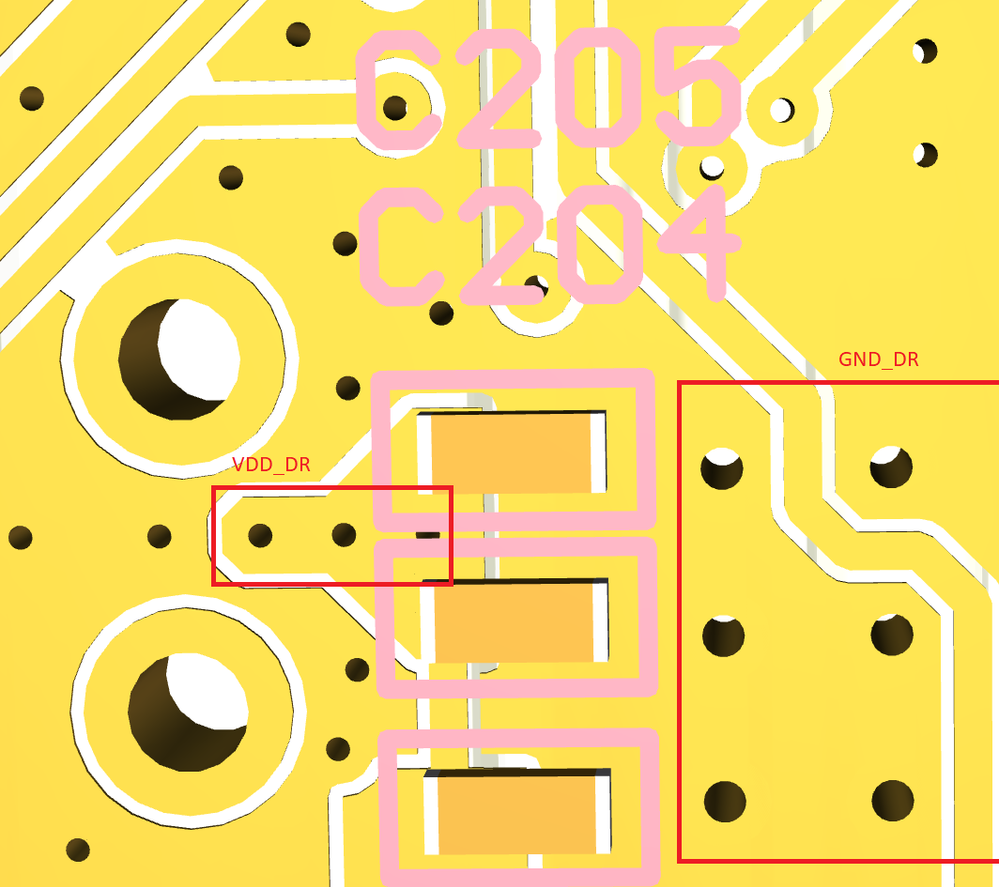

I've noticed that C204 and C205 (tied to the ST25R3916 VDD_RF pin) are populated on the PCB Bottom Layer of ST25R3916-DISCO (The same applies to the NUCLEO board). These are the only components (necessary for the proper functioning of the board) that are soldered on this layer. My (logical) goal is to place the all components of my custom board on TOP Layer for a single reflow process.

Hello Gaston,
In general the caps connected to the VDD_DR pin ( C204 and C205) should be low ohmic connected to VDD_DR and GND_DR.
VDD_DR is the positive supply of the output driver and GND_DR is the negative supply of the output driver. In case of the ST25R3916-DISCO / NFC06A1, this connection has been ensured by 3 vias for VDD_DR and the 9 - thermal vias for GND_DR.

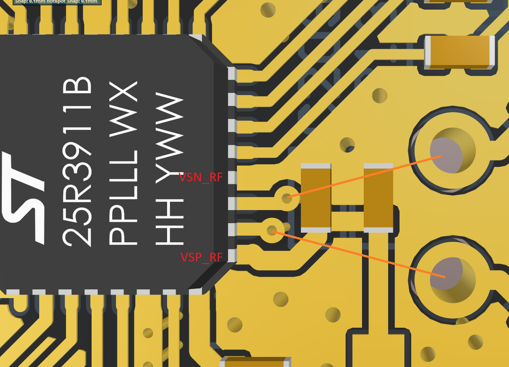

0693W00000590TVQAY.pngAnother nice solution has been done on the ST25R3911B-DISCO and NFC05A1. Here the positive driver supply is called VSP_RF and the negative supply is called VSN_RF.
The decoupling caps for VSP_RF and VSN_RF are kept on top. The EMC Inductors are connected at the bottom layer to the RFO pins.
