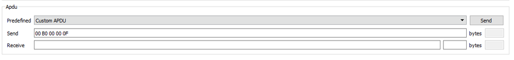

I'm trying to call the ISO-DEP command that you demonstrate in your GUI to send through custom APDU's to the ticket once a connection has been established.
0693W00000Lz0x5QAB.pngI assume i tried to do this previously but was unsure what to set for the parameters uint flags, uint fwt
Thanks in advance for any help you can provide in this manner.

Demo_IsoDep.cpp contains the sequences you are wishing for. Unfortunately that demo is not ported to C# but it should give you a straightforward way to achieve the same in C#.
Best Regards, Ulysses

the rfalConvMsTo1fc is just a macro that multiply the parameter by 13560
#define rfalConvMsTo1fc( t )  ( (t) * 13560 )    /*!< Converts the given t from ms to 1/fc    */
So just change rfalConvMsTo1fc(5) by (5 * 13560).
The 'RFAL' variable corresponds to the flags parameter of rfalTransceiveBlockingTxRx. So put the right value and it should work
