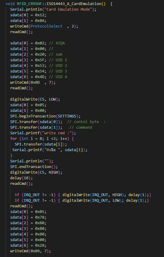

I will provide you with the Arduino code I wrote, so I would appreciate it if you could help me implement the CR95HF card emulator mode.
  1. first GPIO Pin and SPI mode Setting
<Set code >
// Configure GPIO pins : CS = 15, SCK=5, MOSI=6, MISO=7, IRQ IN= 2, IRQ OUT = 1
  if (CS != -1)     { pinMode(CS, OUTPUT);          Serial.println("(1). SPI Chip Select OK");  }
  if (IRQ_IN != -1) { pinMode(IRQ_IN, OUTPUT);      Serial.println("(2). SPI Interrupt Request Ok");}
  if (SSI_0 != -1)  { pinMode(SSI_0, OUTPUT);       Serial.println("(3). SPI SSI_0 Pin Ok");}
  if (SSI_0 == -1)  {                               Serial.println("(3). SPI SSI_0 Pin No use");}
  if (SSI_1 != -1)  { pinMode(SSI_1, OUTPUT);       Serial.println("(4). SPI SSI_1 pin Ok");}
  if (SSI_1 == -1)  {                               Serial.println("(4). SPI SSI_1 pin No use");}
  // Set in SPI mode
  if (SSI_0 != -1)  { digitalWrite(SSI_0, HIGH); }
  if (SSI_1 != -1)  { digitalWrite(SSI_1, LOW); }
  if (IRQ_IN != -1) { digitalWrite(IRQ_IN, HIGH);}
  delay(1);
  if (IRQ_IN != -1) { digitalWrite(IRQ_IN, LOW); delay(1);  }
  if (IRQ_IN != -1) { digitalWrite(IRQ_IN, HIGH); delay(1); }
  SPI.begin(); // arduino sketch SPI begin
  while (!EchoResponse()) {
    if (IRQ_IN != -1) { digitalWrite(IRQ_IN, HIGH); delay(1);}
    if (IRQ_IN != -1) { digitalWrite(IRQ_IN, LOW); delay(1);}

void RFID_CR95HF::writeCmd(unsigned short cmd, unsigned short dataLen) {
  unsigned short i = 0;
  digitalWrite(CS, LOW);
  SPI.beginTransaction(SETTINGS);
  SPI.transfer(0x00);  // contol byte  :
  SPI.transfer(cmd);   // command
  SPI.transfer(dataLen); // length
  while (dataLen == 0) {
    digitalWrite(CS, HIGH);
    break;
  Serial.printf("write cmd :");
  for (i = 0; i < dataLen; i++) {
    SPI.transfer(sdata[i]);
   Serial.printf("0x%x ", sdata[i]);
  Serial.println("");
  SPI.endTransaction();
  delay(10);
// Poll the CR95HF
void RFID_CR95HF::readCmd() {
  while (1)
    SPI.transfer(0x03);
    res = SPI.transfer(0);
      //Serial.printf("==== Read cmd :");
      for (i = 0; i < dataNum; i++) {
        rdata[i] = SPI.transfer(0);
      //  Serial.printf("0x%x ", rdata[i]);
    if ((res & 0x08) >> 3) {
      SPI.transfer(0x02);
      dataNum = SPI.transfer(0);
      Serial.printf("Read cmd :");
      Serial.println("");
      break;
    delay(10);
Function usage is as follows
<example card emulation mode packet >
  1. ;protocolSelect Card emulation for ISO/IEC 14443 Type A
  2. >>02 02 12 0A
  3. << 00 00
sdata[0] = 0x12; // data 0
sdata[1] = 0x0A; // data 1
writeCmd(0x02, 2); // protocol select cmd, length SPI write
readCmd() // SPI Read

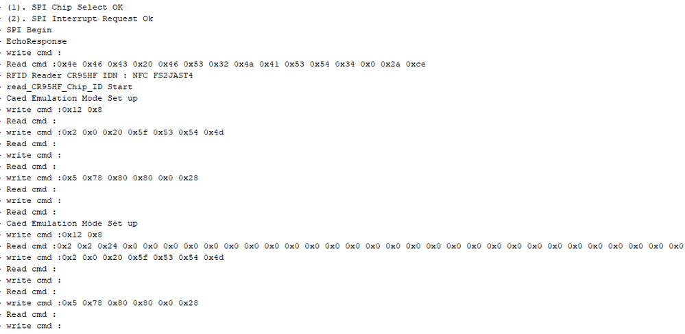

​ 5. Card Emulation Mode Set up
1) select protocol
Tx packet : 0x00 (controlbyte), 0x02(protocol select cmd), 0x02(len), 0x12, 0x08
rx packet : 0x00 should be returned if read normally, but no actual value is returned
2) AC filter
Tx packet : 0x00( controlbyte), 0x0D(AC_filter cmd), 0x07(len), 0x02, 0x00, 0x20, 0x5F(UID), .0x53(UID),
0x54(UID), 0x4D(UID)
Rx packet : 0x00 should be returned if read normally, but no actual value is returned
3) Listen : I wrote a write code, but this part is not written :sad_but_relieved_face:
Tx packet : 0x00(controlbyte), 0x05 (listen cmd), 0x00 (len)
Rx :0x00 should be returned if read normally, but no actual value is returned
4) Tag Send
Tx packet :0x00(control byte), 0x06, 0x06, 0x05, 0x78, 0x80, 0x80, 0x00, 0x28
Rx : 0x00 should be returned if read normally, but no actual value is returned
I've written it up to here

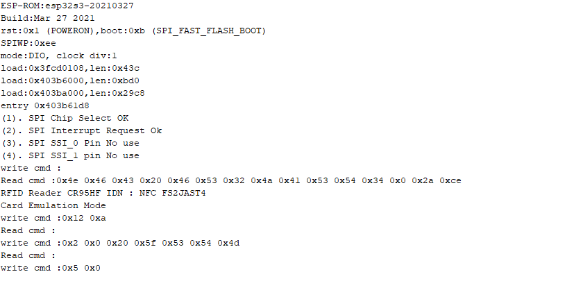

​Since there is no logic analyzer, we replaced it with a terminal window provided by Arduino Integrated Development Environment
card emulation code : help me plz :sad_but_relieved_face:
void card_Emulation_14443A(void)
 Serial.println("Caed Emulation Mode Set up");
 sdata[0] = 0x12;
 sdata[1] = 0x08;
 writeCmd(ProtocolSelect, 2); // Card Emulation Mode Tag type select 14443A
 readCmd();
 sdata[0] = 0x02; //ATQA
 sdata[1] = 0x00;
 sdata[2] = 0x20; // sak
 sdata[3] = 0x5F; // User Tag UID
 sdata[4] = 0x53; // User Tag UID
 sdata[5] = 0x54; // User Tag UID
 sdata[6] = 0x4D; // User Tag UID
 writeCmd(AC_filter ,7);
 readCmd();
 writeCmd(Listen ,0);
 readCmd();
 while(!EchoResponse()) {
  if (IRQ_IN != -1) { digitalWrite(IRQ_IN, HIGH); delay(10);}
  if (IRQ_IN != -1) { digitalWrite(IRQ_IN, LOW); delay(10);}
  readCmd();
 sdata[0] = 0x05;
 sdata[1] = 0x78;
 sdata[2] = 0x80;
 sdata[3] = 0x80;
 sdata[4] = 0x00;
 sdata[5] = 0x28;
 writeCmd(Tag_Send ,6);
 readCmd();
 readCmd();
DJeon.4
Ulysses HERNIOSUS
I think you will need a logic analyzer in the end. Changing the low level/porting will require looking at signals (SPI+IRQ_IN+IRQ_OUT, etc.) and timing. If you are lucky then you can get it working without but experience is that often there are subtle problems in SPI, IRQ handing, timing which cause it not working.
Of course you can go, create hypothesis of what could be the reason or what is happening, change something here and there and you may get it working. But a logic analyzer will tell you straight away what is happening and removes a lot of guessing.
There are inexpensive USB based logic analyzers, please get one!
Best Regards, Ulysses
