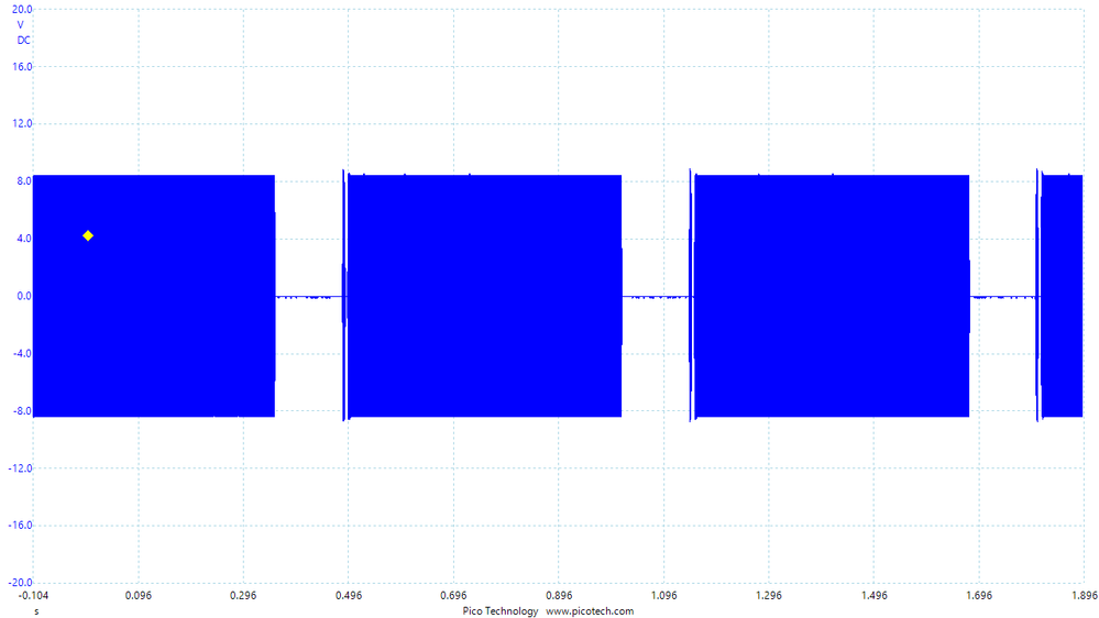

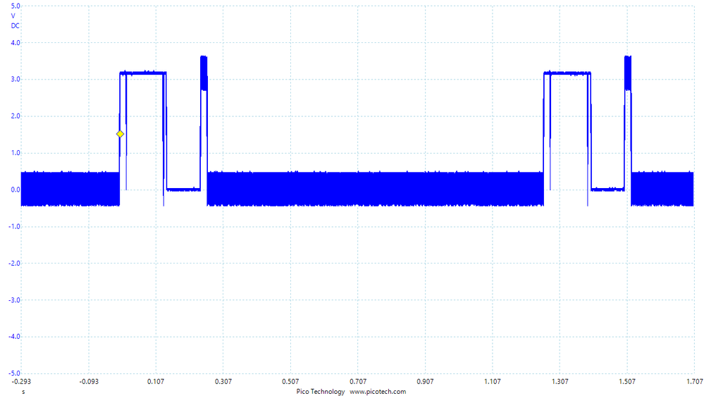

I have the same idea with you. I ported the code based on the code in plf_adaptation.c.
Today, I did the rfalinitialize() and rfalFieldOnAndStartGT() with my ThreadX environment,
and got the a strong RF carrier, which is much stronger than one I did with TRF7960 before.
I was a little exciting for the good first step. I will try to read out UID of ISO15693 next try.
Attached figures is the IRQ and the output of RF carrier. Are they normal?0693W00000QOG8mQAH.png0693W00000QOG8cQAH.png

Brian TIDAL
August 23, 2022
rfalFieldOnandStartGT should return ERR_NONE. I suspect an issue in the adaptation to the threadX platform, likely in the timer management.
I would suggest to enable ST25R_SELFTEST and ST25R_SELFTEST_TIMER as global defines in the compiler command line. Then check the return code of st25r3916Initialize called in rfalInitialize.:
  • ERR_NONE: interrupt, timer and serial communication with the ST25R3916 are OK
  • ERR_IO: serial communication issue (likely not the case here)
  • ERR_TIMEOUT: interrupt management issue
  • ERR_SYSTEM: timer issue (my best guess)
Rgds
