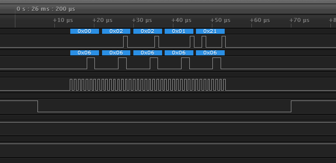

step 1, send the command:
nrf_gpio_pin_clear(SPI_SS_PIN);
spi_xfer_done = false;
APP_ERROR_CHECK(nrf_drv_spi_transfer(&spi, invcommand, 5, NULL, 0));
while (!spi_xfer_done){__WFE();}
nrf_gpio_pin_set(SPI_SS_PIN);
nrf_delay_ms(1);

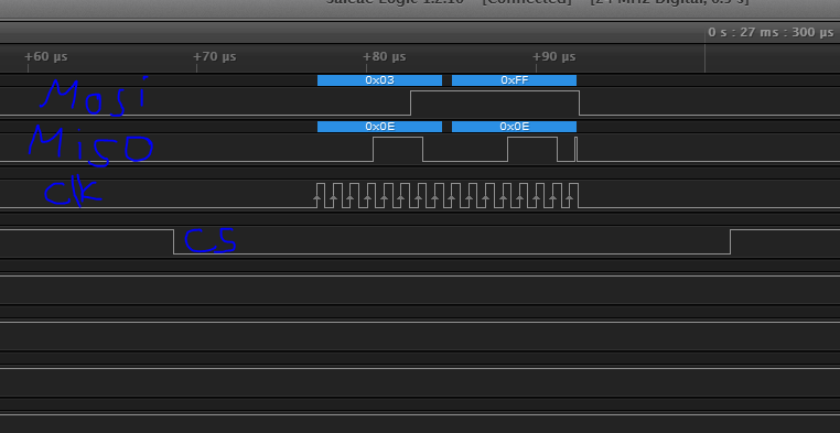

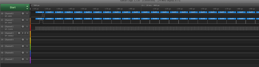

after step 1:
after step 2:
after step 3:
where does this strange response come from (0x0E 0x00 0x00 0x00 0x00 0x00 0x00 0x00.... 0x00 0x00 0x00 0x00)?
why do i get 0x0E so often?

The SPI interface is working properly the issue come from the command you send ( uint8_t invcommand[5] = {0x00, 0x02, 0x02, 0x01,0x21};) which is not a known command for the CR95HF
Assuming you are in ISO 15693 you need first to initiate your protocol using the protocol select command I suggest to modify as follow : uint8_t invcommand[4] = { 0x02, 0x02, 0x01,0x21};
according to the specification https://www.st.com/resource/en/datasheet/cr95hf.pdf see sheet 20/21
The SPI answer 0x0E means that the busy flag is off only the bit 3 is significant.
I can also suggest to check your SPI interface using the echo command described in the datasheet.
