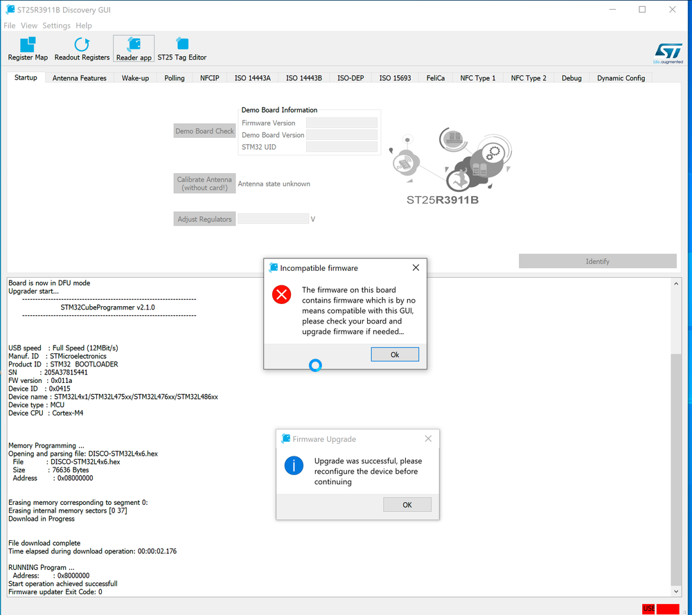

I tried to run the test tool on my Win10 VM. I kept getting error message even after a required firmware update. How can I make it work again on my Win10 VM?
GUI version: 1.2.12.0.0693W00000D1CP7QAN.png
Thank you,
Min-Ching Ho

The firmware update seems working fine. The screenshot shows 2 events in it. I first get the upgrade success message and couple seconds later I saw the error message that firmware is not compatible. The error message always happens with or without firmware update. Can you please check it again for me?
Min-Ching Ho

I tried on our Vmware, Win10 VM on Win10 host: It worked using the 1.2.12.
BR, Ulysses
MHo
It turns out the broad is broken. After I switch to another one, it works right away.
