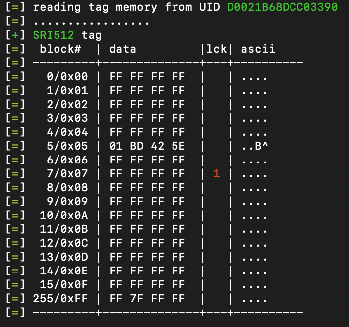

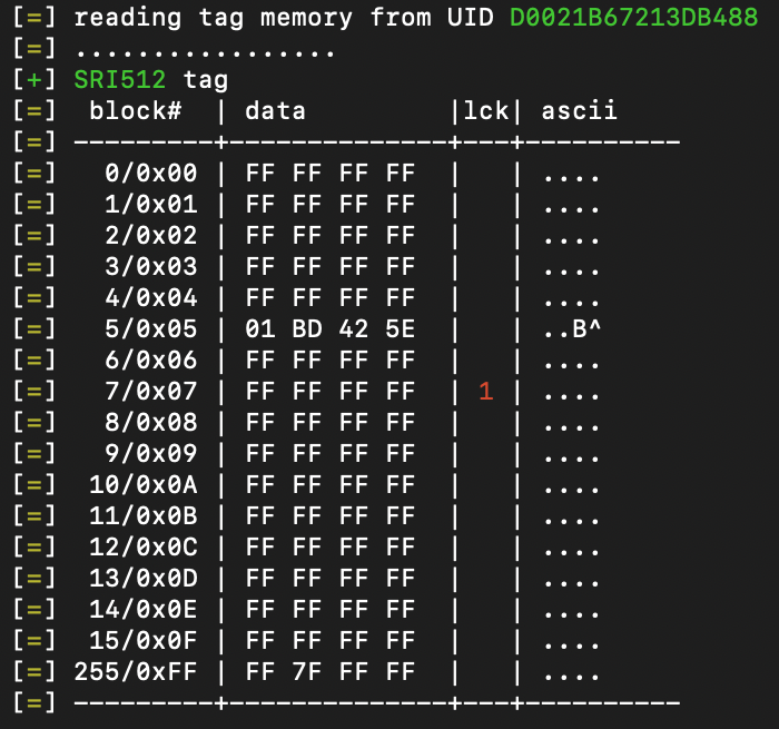

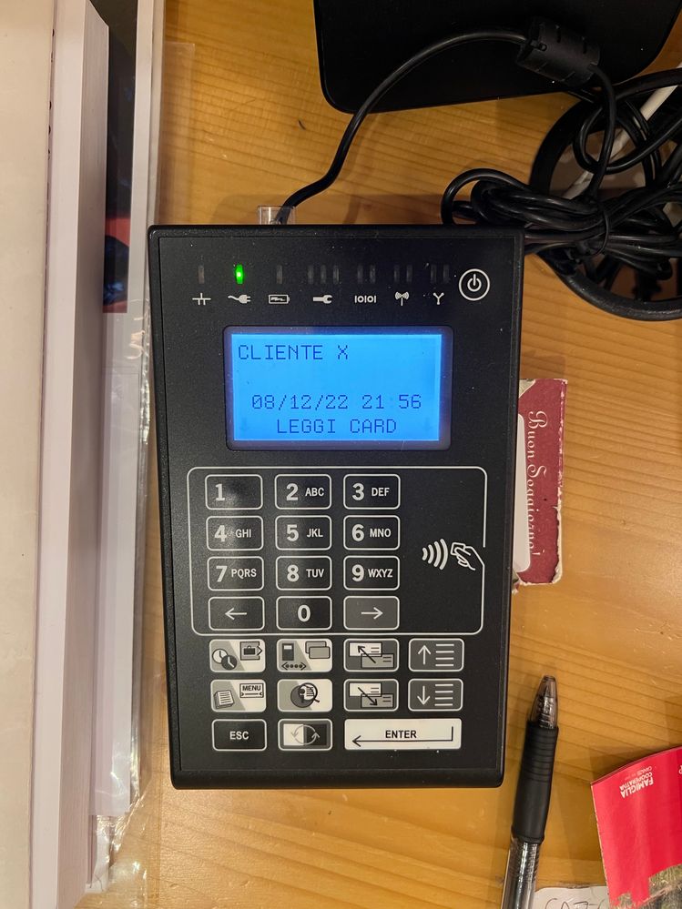

Hello, sorry for the inconvenience but I really can't understand why I can't write/read new cards (the ones he has work) from my customer reader. What am I doing wrong?
I enclose the photos, his card (working and writable / readable) and the one I created for him.

Berenice BENVEGUDA
first of all thanks for your interest in ST25 tag products.
on SRI512, block 5 corresponds to a count down binary counter.
You can only write a value which is smaller that the current one in this block.
Best Regards,
BB
