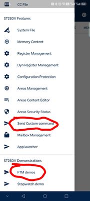

As soon as a ST25DV is connected through I2C to an MCU running the FTM protocol, the ST25 App FTM demo can be used.
So, make sure to connect the needed pins from the module to your MCU and run the FTM protocol FW on the MCU.

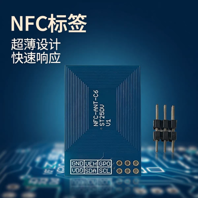

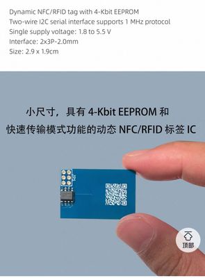

As you mentioned the ST25TA-E Secure Tag, I found the similar NFC module which can use ST25 APP to write/read NFC tag by NDEF.
The NFC module parameter:
Is this NFC module can communicate with ST25 app by mailbox to "Send Custom command" or even use "FTM demos" to exchange massvie data over 256 bytes?
