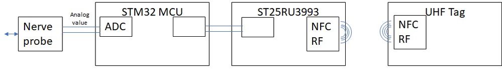

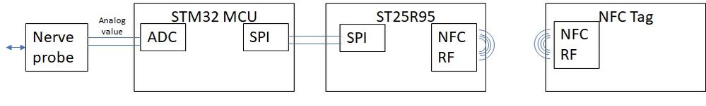

​Hi,
ST25DV-DISCOVERY is is based on NFC ST25DV04K Dynamic tag. Anyway, this can be used for protoyping applications for ST25DV-I2C series Dynamic NFC Tags.
ST25RU3993 is an UHF reader used to read/write UHF tags. Do you plan to store you records inside a tag? Something like:
(or like this in case of NFC)
Feel free to clarify your use case:
  • data storage; in a tag or in a device attached to the reader?
  • reading distance (impact on choice between UHF and NFC)
  • data volume,
  • etc.
Rgds
BT
