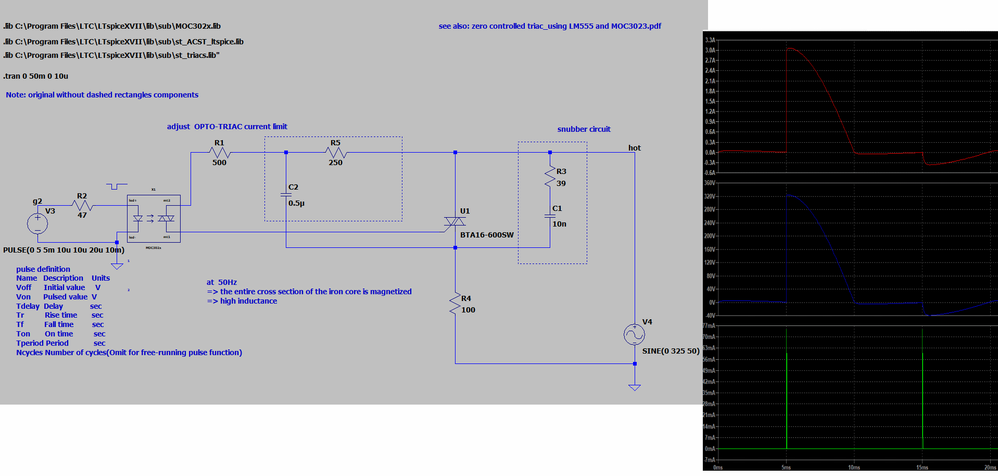

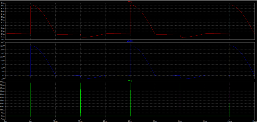

we use the triac BTA/BTB16 for 1 Phase Control of a Feeder ( 230 VAC, 50 Hz). attached the LTspice- Simulation. Question: why is the current not symetric ? Bernd

TEXT 664 680 Left 2 !.tran 0 50m 0 10u
TEXT 664 576 Left 2 !.lib C:\\Program Files\\LTC\\LTspiceXVII\\lib\\sub\\st_ACST_ltspice.lib
TEXT 2344 840 Left 2 ;snubber circuit
TEXT 704 1264 Left 2 ;pulse definition \nName   Description    Units \nVoff      Initial value     V  \nVon      Pulsed value  V  \nTdelay  Delay             sec  \nTr          Rise time       sec  \nTf          Fall time         sec  \nTon       On time          sec  \nTperiod Period            sec  \nNcycles Number of cycles(Omit for free-running pulse function)
TEXT 1048 1240 Right 0 ;1
TEXT 1048 1328 Right 0 ;2
TEXT 1160 832 Left 2 ;adjust  OPTO-TRIAC current limit
TEXT 664 616 Left 2 !.lib C:\\Program Files\\LTC\\LTspiceXVII\\lib\\sub\\st_triacs.lib"
TEXT 1984 528 Left 2 ;see also: zero controlled triac_using LM555 and MOC3023.pdf
TEXT 672 736 Left 2 ;Note: original without dashed rectangles components
TEXT 1280 1304 Left 2 ;bei 50Hz\n=> der gesamte Querschnitt des Eisenkerns magnetisiert\n=> hohe Induktivität
TEXT 664 528 Left 2 !.lib C:\\Program Files\\LTC\\LTspiceXVII\\lib\\sub\\MOC302x.lib
