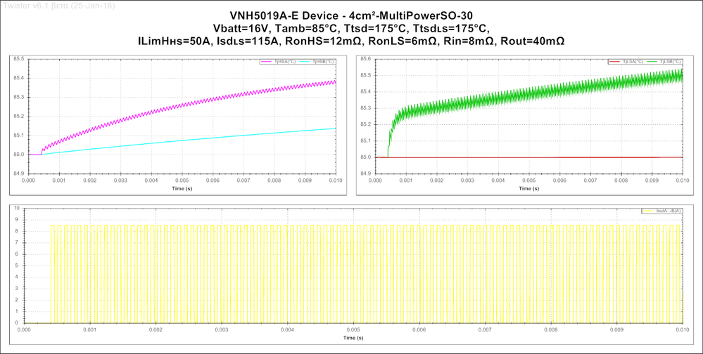

Posted on March 09, 2018 at 07:43
hello  leonardo,
Really thanks for your reply.
16 cm^2 heat sink is really big. it should be not that much in actual design.Per your calculation,it can't work in 85C operation temperature.but I have to say,your calculation process is a little difference with Table 17 page27.

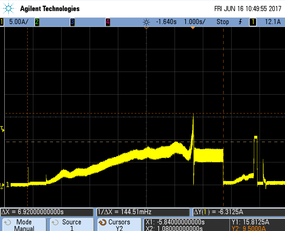

following picture is load work current curve in a cycle.
the total work time in a cycle  is about 7ms. peak current @8~9A. PWM frequency is 10Khz.
total PCB heat sink for CHIP1,CHIP2,CHIP3 is 4CM^2  .could you give a more detail analysis?

Posted on March 22, 2018 at 10:18
Hi Horace,
For detailed thermal simulation my suggestion is to use the
TwisterSIM available for free at
/external-link.jspa?url=http%3A%2F%2Fwww.st.com%2Ftwistersim%2520and%2520include%2520all%2520M05
Ithasa graphical interface and it's a easy way to perform accurate thermal simulation especially in transient condition.
For example I performed the case you requested: VNH5019 with a Load=9A,
mailto:PWM@10KHz
(50% DC) 7ms cycle Tamb=85°C. Here attached the relatedplot:
As you can see no issue to drive this load.

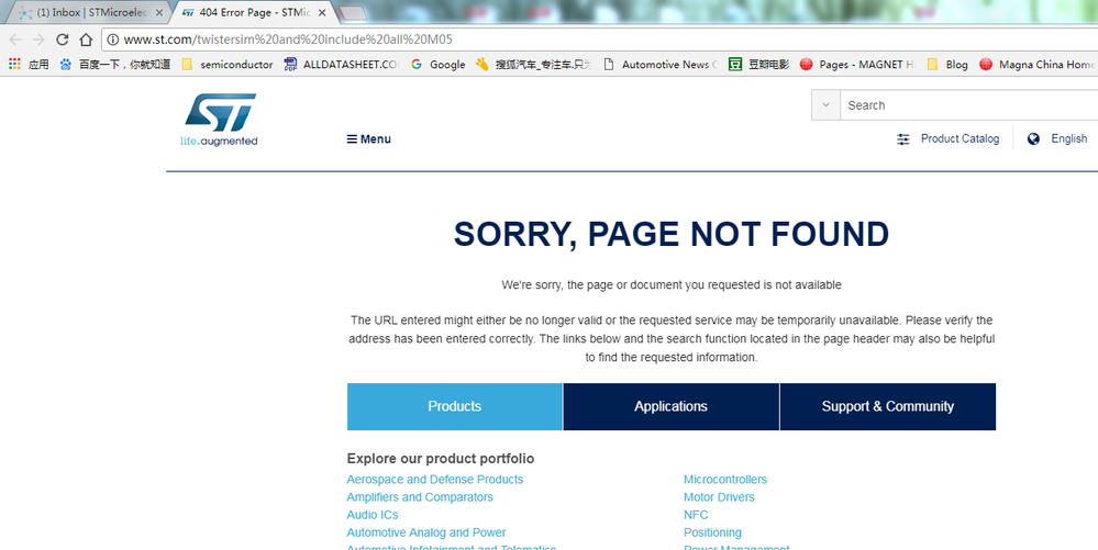

Posted on April 25, 2018 at 11:16
sorry, I can't get the analysis tool,could you help check if it is available now?
