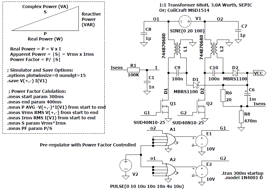

Using A6727 or L6726A buck controllers as a boost controllers
Can either A6727 or L6726A buck controllers be used as a boost controllers by connected the high side driver (Phase) to 0V to drive my power transistor?
Alternatively do you have spice models that I could use on LTspice or Tina-TI for example. Please alternatively recommend a low voltage controller that operates in voltage mode but not current mode and does not have feed-forward.
Explanation - I am not working so I have given myself a design exercise to design a bicycle dynamo power manager. The dynamo current taken has to be limited in-order to achieve maximum power transfer. LTspice simulation below.
