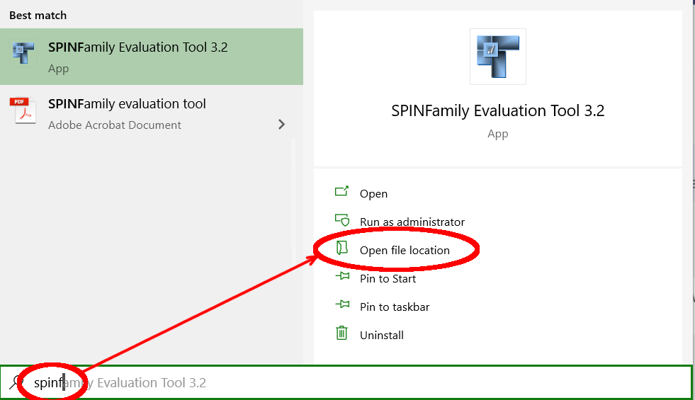

As UM2022 says, the file guifw-STM32XXXXX-nucleo.bin should be already located in your installation path of SPINFamily, where you find it in folder Firmware.
Of course this filename is just a placeholder for the real name, i.e. for your NUCLEO-F401RE the filename is: Guifw-STM32F4xx-Nucleo.bin
You may have been confused by UM2022, which still uses older Windows references, e.g. for the StartMenu. According the steps suggested by UM2022 and assuming that you are already using Windows 10, you will find this location by Start > SPINFamily > Open File Location, where you will find the Shortcut to Firmware:
Does it help?
Good luck!
/Peter

Hi Peter,
thank you for your answer. I reinstalled the tool and found the Firmware folder as you suggested, and downloaded this to the Nucleo board. All working now, although I am not sure what I missed when I first tried. But its working now :)
