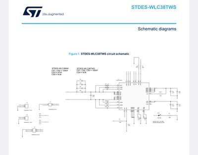

We need the schematics to eb checked for 10W power output

if external do not have pull up res, SCL/SDA/qi_nINT need pull up res to VDD.
https://www.st.com/resource/en/data_brief/stdes-wlc38tws.pdf Screenshot_2024-03-04-19-21-15-72_e2d5b3f32b79de1d45acd1fad96fbb0f.jpg
Hi, we could communicate with the IC alright. However the charging is not happening although The wireless transmitter shows transmitting. In EVK the resistance is 100k.
Is insufficient power out may be due to this resistance?
willzhou
In EVK the resistance is 100k. It is for enb pull down.
About insufficient power out , can you get some waveform on VRECT/VOUT pin, so we can have more detail information.

1.When the wireless charger is in place and the wireless charging coil is on top of it, RX is working, so i2c module is working. So it is normal.
2.From your info,
vrect = 0x0BE3 = 5732mV
vout = 0x0015 = 25mV
icur = 0x0021 = 41mA
tmeas = 0x013D = 47.5C
it seems vout do not get 5V output voltage.
