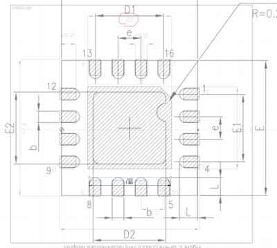

STOD32A has wrong dimension in the datasheet
Dzor
D2/E2 should be 1.95, not 1.7.
3x0.55+0.3=1.95
https://www.st.com/en/power-management/stod32a.html
1 REPLY 1
Dzor
Actually, D2 and E2 should simply be not referenced on the drawing.
0.55 should be 0.5, per `e` dimension.
So now 3x0.5+0.3=1.8mm
It should be numerically written 1.80 and then everything starts to make sense.
Here is an overlay:
And here is corrected drawing:
