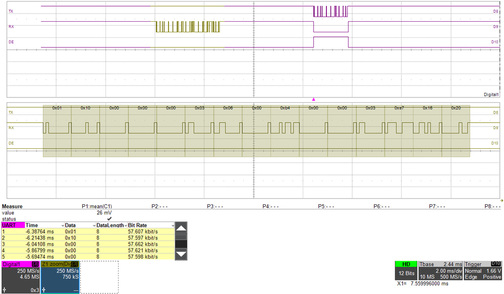

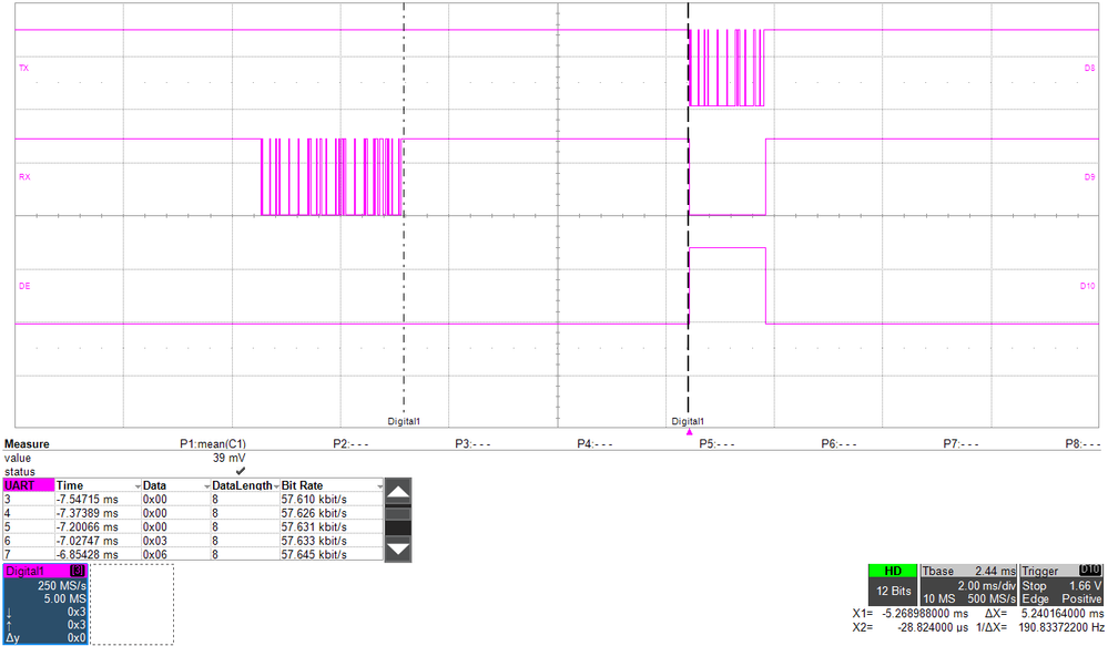

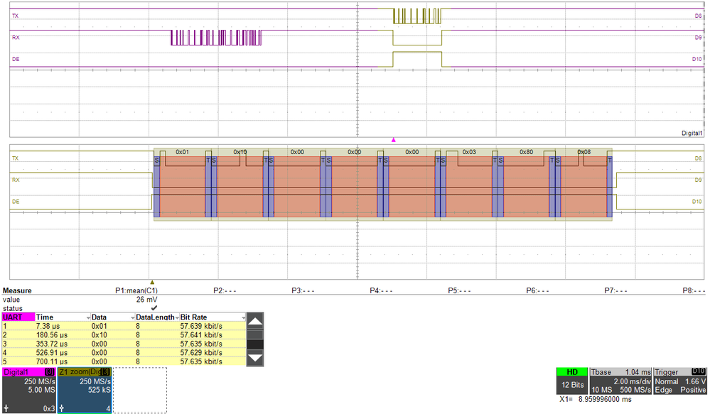

Enrico Poli
Hi Liam,
I did some tests.
The communication at 57600 works properly in my setup (QModMaster + FTDI USB-RS485 transceiver)
Attached some screenshots.
The delay between the end of RX frame and the transmission of the acknowledge frame is of about 5 ms, so I think you should wait few ms after the acknowledge is sent before a new frame.
I also did a test at 115.2k, but at this speed the UART communication fails.
