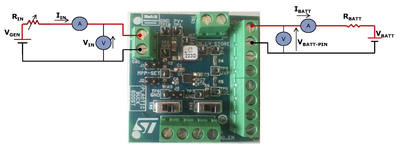

I use my solar panel connected to the STEVAL-ISV020V1 to charge my LiPo battery. Everything works fine and it charges the battery. However since I am trying to charge it indoors, during night-time, my solar panel doesn't reach the min required voltage of 2.6 to operate the STEVAL-ISV020V1.
Now I am wondering if the STEVAL-ISV020V1 becomes a load instead of being a charge controller when this happens because it drains the battery with a very low voltage at a certain time.

I followed this diagram below attached screenshot from its datasheet:
The Solar panel is connected to CN1 and the battery is connected to the outputs. No other connections were used to the battery.
Solar Panel -> STEVAL-ISV020V1 -> LiPo Battery

The evalkit is the Buck-Boost variant, which only starts from 2.6V when a PV panel is first connected, but can then work down to 150mV and even charge the battery, even if only very low charging currents are flowing. The battery is disconnected from STORE as soon as its voltage exceeds EOC and connected when the voltage falls below EOC (see SPV1050 data sheet mentioned above).
However, I would also like to point out that the internal LDOs can certainly cause this discharge, as also mentioned in the data sheet, section 6.5:
...the LDOs are both supplied by the STORE rail: if the input source is unable to sustain the current required by the load, then the missing energy will be supplied by the battery connected to the BATT pin.
and
If VSTORE drops and UVP pin triggers the undevoltage threshold, then the pass transistor gets open and the load is no longer supplied until next end of charge condition is reached.
Even if switches SW1, SW2 are set to position 4 (GND) and the LDO are thus disabled, a standby current of typically 0.8µA can still flow, which can lead to significant discharge depending on the type and size of the LiPo. And please don't forget the self-discharge of your LiPo battery.
