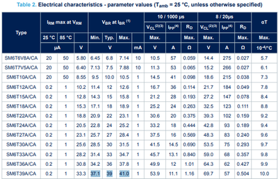

Hi, I have SMBJ33CA-TR diodes. I am measuring the breakdown voltage, Ubr. According to the technical documentation on your website, the acceptable values range from 36.7 V to 38.6 V. However, I am measuring values above these limits, with Ubr = 40.163 V, Ubr = 39.260 V. Please clarify if the documentation has changed, and if so, whether the Ubr limits are higher than those specified in the DS1283 - Rev 13 - October 2024 datasheet.

The values specified in the data sheet apply to the environmental conditions specified therein. In addition, the SMBJ33CA-TR is not a zener diode with static data, but a TVS designed to protect against voltage pulses (see e.g. data sheet, fig. 1 and 2). The breakdown voltage is also determined by the dynamic resistance, which increases with increasing pulse duration (see data sheet, fig. 6).
This is therefore not a data sheet error, but has to do with your measurement method.

SMBJ33CA datasheet specifies minimum and typical VBR values. Maximum value is not specified. VBR Min = 36.7 V, VBR Typ = 38.6 V.
Equivalent part is available on SM6T family, SM6T39CA. Maximum VBR value is specified.
VBR Max = 41 V. Value you measured is lower than this maximum value.
Hoping it answers your question.
