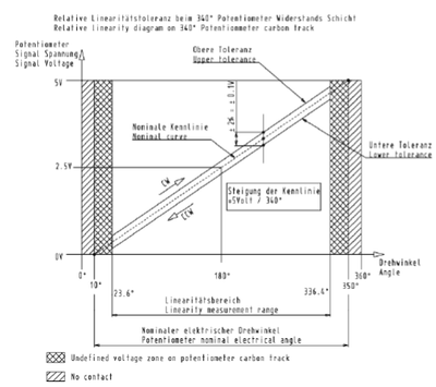

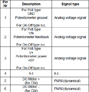

How do i control the angle of the motor?
I think I need to change the voltage I enter into the potentiometer, what should I do?

With a little more information, the passing reader would immediately know what it is about and could answer you.
- What kind of motor do you want to control?
- Which potentiometer are you talking about?
- Where can you find documentation for the screenshots you posted, which are not very useful (please add URLs)?
