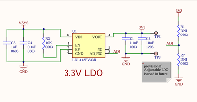

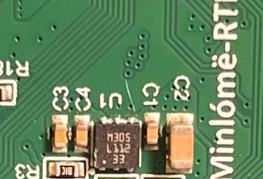

Recenlty I designed the my custom board with LDL112PV33R . My Vin is from Battery charger BQ25620 which is 3.7V. Now LDO giving directly 3.7V at Vout. I done following diagostics.
  1. check marking on IC which ic ''L112 33''. which is indicating Fix 3.3V output variant. check image

  3. Checked shematic design. I think that is ok . sharing the image.

Welcome @sauravpanchal369, to the community!
The marking is the right one for the LDL112PV33R.
Unfortunately, you did not include your layout, so we cannot check it. However, pin 2 (GND) is not connected, so please connect it to GND.

sauravpanchal369
Hello @Peter BENSCH ,
Thank you very much for pointing out that. I connect pin2 to ground externally and it worked.
Thanks again
