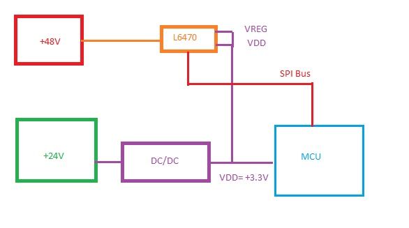

I am designing the system with both L6470PD and L6472PD stepper drivers. Since my system is operating on 3.3V (MCU is STM32F103 ) I have tight the VReg with VDD line as suggested. The problem which I am facing is following. I supply the drivers from 48V while the MCU via DC/DC converter from 24V to 3.3V. If I am turning of the 24V only the logic is still supplied via VREG embedded in Stepper driver ( since 3.3V line is tight with Vreg ). This condition is not good for my application since a) ST not recommended to supply anything from this VREG b) I wanted to be able to turn of the logic completely when I turn on the 24V.
Please advice since it is not clear for me, can I maybe place the Schottky diode between VDD and VReg so there will be no possible supply the system from Vreg?
Or maybe I can leave open the Vreg and not tight this to VDD
Any suggestion is more than great.
Thank you very much
Jacek

Is it possible you can draw and post a block diagram of the power sources and how you have them connected or wish to have connected ? Not 100% following the setup. You can also submit this as a support request via support home via web request on st.com

Hello Bryan,
Thanks a lot for quick replay.
Here is the block diagram..
Basically I am planning to use 48V to supply the power stage of the H-bridge in L6470 to drive the motors with defined torque. +24V is my main power supply for the rest of electronic system. I am rectify from 24 to 3.3V to supply MCU, Following to spec from L6470 I tight the VREG and VDD to 3.3V line. Now there is a scenario when I unplug the +24V input the MCU is still alive since is sourced from internal VREG from L6470 which is not good in my case ( i need switch off logic completely ). Can I place the Schottky diode in the way that I will be not able to source from VREG the logic , and if yes what I am risking there?
Thank you very much
Jacek

Well, I am not an expert on this part, but it appears the :
The Vreg and VDD are indeed supplied externally.. I had to clear that up in my mind.
If you turn off 24volts, it seems all the 3.3 lines will be 0 volts, both the motor driver and MCU.
So I don’t see any need for steering diodes. Sorry, I have not worked with the part before, just reading datasheet, and trying to put myself in your situation.
Best Regards,
Bryan
Jacek Pieczaba
Jun 10, 2019 7:30 PM UTC
Thanks a lot for replay. Unfortunately is working in this way if I turn off 24V I will have 3.0V on the VDD rail ( not 0V ) from the internal regulator embedded in the L6470PD ( Internal VREG rectify from 48V to 3.0V ) , so my MCU will still respond. So my idea around Schottky diode was to not allow to feed anything from VREG.

IS this measured ? I did not see the Vreg being powered from the connections from main power ☺
I will look again
Jacek Pieczaba
Jun 10, 2019 7:37 PM UTC
Yes it is measured...
BRYAN SPEED
Visitor II
Jun 10, 2019 7:46 PM UTC
Yes, of course, I did not read enough..! has been a rough morning.
So.. most elegant and simple perhaps, a “switch�? in line with L6470 Vreg, that the truth table is 24v = 1, switch on. 24v = 0 , switch off. So a series FET - so neither 24v supply output or mcu can see l6470 vreg voltage when 24v is off
Does that makes sense to you ?
Jacek Pieczaba
Jun 10, 2019 8:15 PM UTC
Bryan,
No problem Mondays are almost always a bit hectic. You know maybe I will do a bit different approach, I will use the LVD from MCU. If I am seeing voltage below 3.0V it will means that I 24V is out so I will place MCU in the idle state , if the voltage is above 3.3V will means that everything is great and lest rock and roll.
series FET are good idea but it is a extra cost the same like with Schottky diode.
Thanks a lot

Aug 10, 2019 12:33 PM UTC
Bryan,
Just to keep you updated. I was running some tests and it looks that if I simply disconnected from the 3.3V rail the VREG pin.
Thank you
