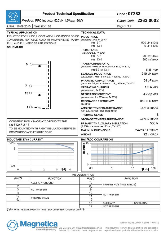

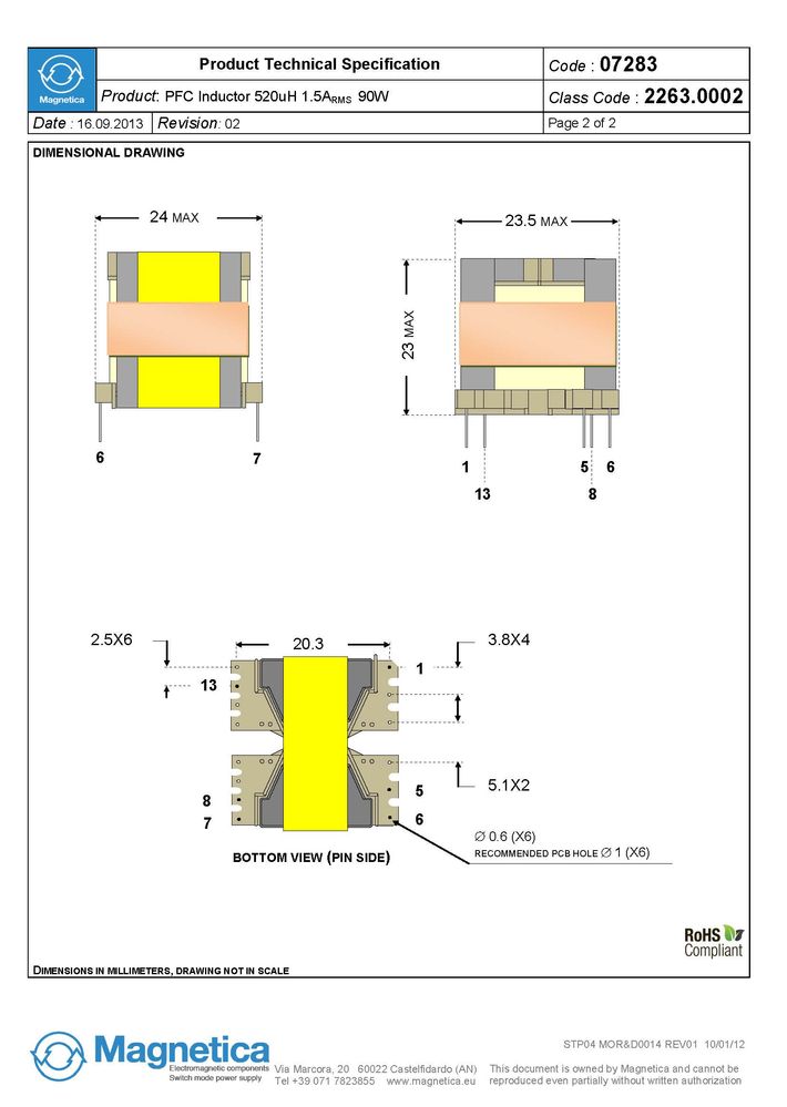

In the document EVLCMB1-90WADP, is L2 a simple inductor or a transformer? If it is a transformer, then what is the turns ratio?

Thanks to Magnetica!!!
