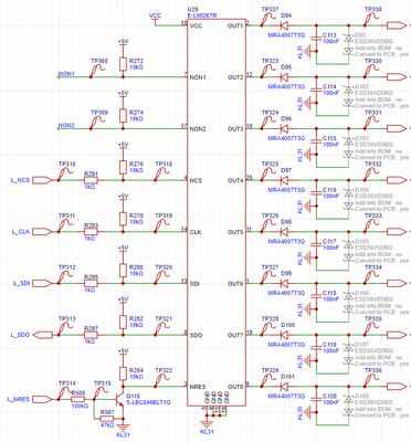

I ran into some problems with the E-L9826 low side driver.
JC3
Here is my hardware design.
The output with load goes high during chip reset. When I cancel the reset, the output immediately goes low before I have done any control. I turn the output on or off again with no effect and at this point the diagnostic data is 0xff. Is there something wrong with my hardware design?
