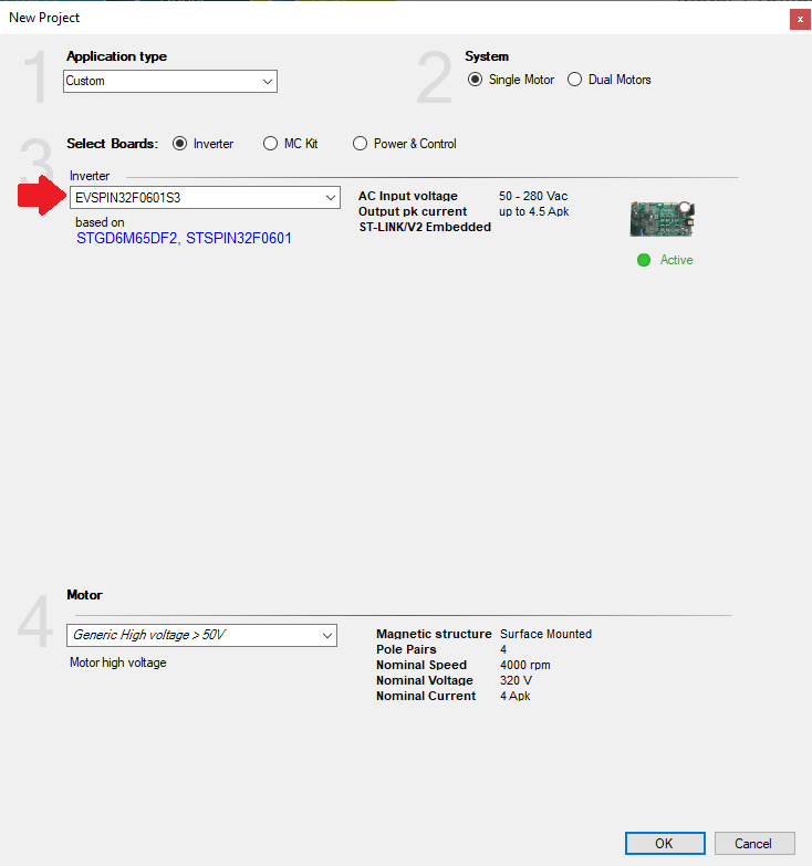

How can i create Custom motor details to use in Motor Control Work Bench. I am using EVSPIN32F0601S3. Any suggestions??/

Open the ST Motor Control Workbench and click on new project. Select the board as shown in the figure below.
0693W00000592A1QAI.pngThen, click ok and in the project click on the motor: there you can customize the motor's parameters.
0693W00000592B9QAI.pngLet me ask you some more details about your description:
- Rated Voltage - 60V
- Back EMF - 60, what do you mean exactly ?
- Pole 4, in the tool you need to set the pole pairs, so in your case 2
- Frequency 120 Hz. It is not clear what this frequency is referred to. It does not match with a speed of 2500 rpm.
Remember to set in the parameters the Resistance and the inductance of the motor’s phases.
Moreover, set all the parameters related to the application such as voltage supply, nominal current and the start-up sequence
One remark about the power: check that the maximum current of the power stage is less than the overcurrent threshold (4.5A peak)
I hope this can help you, let me know how it is going.
