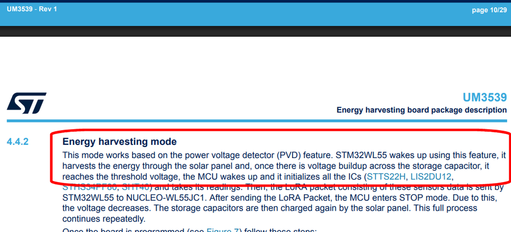

Are there any more resources to understand how to use STEVAL-HARVEST1, how does the energy flow from super capacitors to the MCU and also the back up capacitors. I feel few things are missing the schematic and the user guide. I want to first implement a small UART program with energy harvesting. Can anyone guide through steps in achieving it.image.png
How to connect this to board, does it mean I need to add any external wire from harvester solar panel and short it here?
I have read
https://www.st.com/resource/en/user_manual/um3539-getting-started-with-stevalharvest1-energy-harvesting-board-for-nucleowl55-stmicroelectronics.pdf
https://www.st.com/resource/en/schematic_pack/steval-harvest1-schematic.pdf
https://ieeexplore.ieee.org/stamp/stamp.jsp?arnumber=11369460
Thanks in advance.

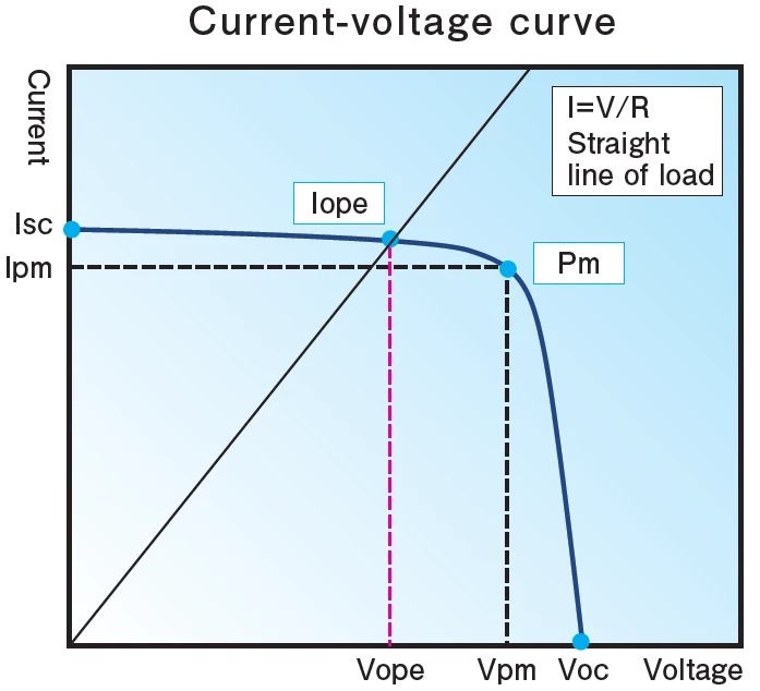

Best answer by Peter BENSCH
The 5V specified in the Panasonic catalogue are the open-circuit voltage, which is never reached when connected to the board because of its current consumption. The catalogue lists for the AM1815:
  • Voc = 5V (open-circuit)
  • Isc = 48.2µA (short-cut current)
  • Vope = 3V (operating voltage) @ Iope = 45.7µA (operating current)
It also states, that the "Current drastically changes under Vpm or higher" (Vpm = Optimum power operating voltage):

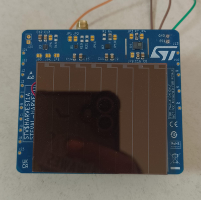

SaiVenkatAuthor
March 26, 2026
Thank you for the response. I reviewed the materials you pointed to and wrote a small test program to toggle a GPIO in order to observe the harvesting behavior. However, I still do not fully understand how the system is intended to be configured in harvesting mode.
From the referenced image, my interpretation is that the positive terminal of the energy harvester should be connected to VDD_MCU. What is not clear to me is what exactly is meant by the “positive terminal” in this context.
After examining the schematics of both the harvester board and the WL55 Nucleo board, I assumed that, in order to charge the tantalum capacitors (C2, C4) on the harvester, the solar panel output should be routed to the E5V pin. My understanding is that the ~5V from the solar panel is then regulated down to 3.3V by the onboard LDO, supplying both the MCU and the storage capacitors when the harvester is connected.
To implement this, I connected C7 pin 2 to pin 6, effectively routing the solar panel output to the E5V rail.
With this setup, I observed that the voltage across the harvester capacitors (C2, C4) does increase, but very slowly. The maximum voltage I observed was around 2V, after which it quickly drops to approximately 1.7V.
My questions are:
  1. Is connecting (or effectively shorting) the solar panel output to the E5V pin the correct approach, given that this step is not explicitly described in the documentation?
  2. If this approach is correct, what kind of charging time should I expect before the system can reliably execute a simple task like a blinking LED?
  3. If this approach is not correct, what is the proper method to charge the capacitors C2 and C4?
  4. I understand that the supercapacitor C1 is charged via a GPIO, but I am unclear on how the stored energy from C1 is then used to power the system.
Any clarification on the intended power flow and correct hardware setup would be very helpful.

Peter BENSCH
April 23, 2026
@SaiVenkat
The intended harvesting setup is not to connect the solar panel directly to E5V.
In energy harvesting mode, the solar cell charges the storage capacitors on STEVAL-HARVEST1 through the board’s harvesting path, and the MCU is then powered from the stored energy when the voltage reaches the PVD threshold. The “positive terminal” simply means the positive supply node of the harvested energy path, not the raw solar panel output routed to E5V.
So, in short:
  • Do not use the solar panel as a direct E5V input for harvesting mode
  • Follow the jumper configuration shown in UM3539 Figures 9...11
  • Open SB32 for harvesting mode
  • Program the board first in continuous mode, then switch to harvesting mode
The slow rise to about 2V and then collapse to 1.7V usually indicates that the available harvested energy is still insufficient, or that the board is not configured in the intended harvesting power path.
A practical bring-up for a first UART test would be:
  1. Start in Continuous Mode and program the board via USB
  2. Use a minimal firmware: initialise UART, send one short message, then enter STOP mode immediately
  3. Verify that the UART output works in stable power mode first
  4. Then change the board to Energy Harvesting Mode as described in UM3539: set the jumpers as shown in Figures 9...11 and open SB32
  5. Expose the solar cell to light and monitor the storage capacitor voltage
  6. Confirm the expected sequence: charging -> MCU wake-up via PVD -> UART message -> STOP mode -> recharge
For the first test, avoid long logging, blinking LEDs, or sensor reads, as the harvested energy margin is usually very small.
Hope that helps?

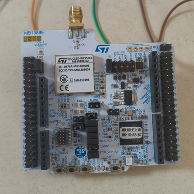

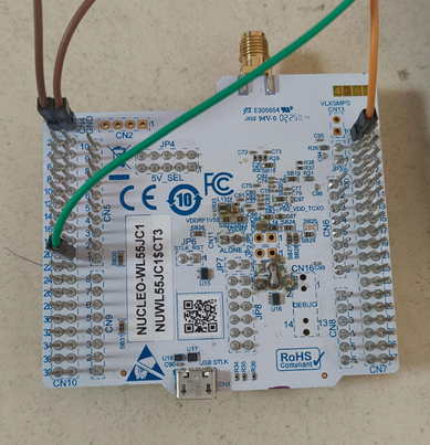

SaiVenkatAuthor
April 27, 2026
Thank you for your response Peter,
I have wrote a small code for testing which makes the MCU wake using PVD then print a "Hello" message on UART1 and goes to stop mode.
 pwr.PVDLevel = PWR_PVDLEVEL_6;
 pwr.Mode = PWR_PVD_MODE_NORMAL;
 HAL_PWR_ConfigPVD(&pwr);
 HAL_PWR_EnablePVD();
 HAL_UART_Transmit(&huart1, (uint8_t *)"Hello", 5, 100);
 HAL_SuspendTick();
 HAL_PWREx_EnterSTOP2Mode(PWR_SLEEPENTRY_WFI);
It is working perfectly fine in Continuous mode through USB power, but this is not working in Energy harvesting mode.
These are the connections that I have made
SaiVenkat_0-1777270998184.pngSaiVenkat_1-1777271037415.pngSaiVenkat_3-1777271465330.png
One thing I never understood is how does the power flows from the solar panel to the nucleo as VPV pin is connected to nothing. Do I need to short it to anything like VPV and VDD needed to connected or something. I think it should not be done as according to the datasheet max the pin can take is only 3.6V
And my other doubt is according to figure 11 from um3539, does JP9 and JP1 needed to be shorted? I think both are already shorted on the board, as per my understanding there is nothing to do with figure 11 correct me if I am wrong.
Thanks in advance
Sai Venkat

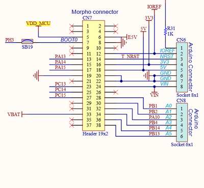

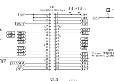

@Peter BENSCH @Andrew Neil , Can you just clear me one thing nothing else. Where does VPV power goes first. As per my knowledge from the STM32WL55 schematic and steval harvest1 schematic , VPV is connected to nothing on CN7.
                                                   STM32WL55 CN7 Pin 2 connected to nothing
                                                  STEVAL_HARVEST_1 CN7 Pin 2 connected to nothing
 With VPV not connected to anything how does anything charges or power flows anywhere
Peter BENSCH
April 30, 2026
I do not currently have access to the kit, but in UM3539 a jumper appears to be missing on the NUCLEO-WL55JC1 between CN7.1 and CN7.2. If fitted, this jumper on the STEVAL-HARVEST1 connects the VPV line to VDD, which is then routed via CN7.5 to the NUCLEO-WL55JC1 at VDD_MCU. You can simply plug the jumper onto the NUCLEO from below.
Hope that helps?
Regards
/Peter
