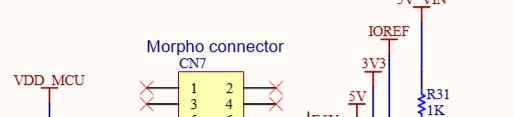

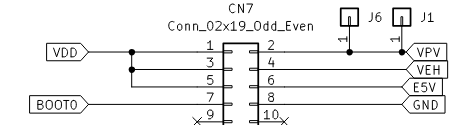

@Peter BENSCH @Andrew Neil , Can you just clear me one thing nothing else. Where does VPV power goes first. As per my knowledge from the STM32WL55 schematic and steval harvest1 schematic , VPV is connected to nothing on CN7.
                                                   STM32WL55 CN7 Pin 2 connected to nothing
                                                  STEVAL_HARVEST_1 CN7 Pin 2 connected to nothing
 With VPV not connected to anything how does anything charges or power flows anywhere
I do not currently have access to the kit, but in UM3539 a jumper appears to be missing on the NUCLEO-WL55JC1 between CN7.1 and CN7.2. If fitted, this jumper on the STEVAL-HARVEST1 connects the VPV line to VDD, which is then routed via CN7.5 to the NUCLEO-WL55JC1 at VDD_MCU. You can simply plug the jumper onto the NUCLEO from below.
Hope that helps?
Regards
/Peter

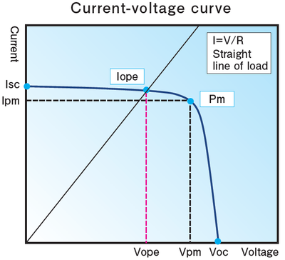

However, I still have one concern. The solar panel provides a 5V output, while the capacitor in the datasheet is rated for 4V, and the MCU maximum rating is 3.6V. In that case, wouldn’t directly shorting or connecting them cause damage?
The 5V specified in the Panasonic catalogue are the open-circuit voltage, which is never reached when connected to the board because of its current consumption. The catalogue lists for the AM1815:
  • Voc = 5V (open-circuit)
  • Isc = 48.2µA (short-cut current)
  • Vope = 3V (operating voltage) @ Iope = 45.7µA (operating current)
It also states, that the "Current drastically changes under Vpm or higher" (Vpm = Optimum power operating voltage):
