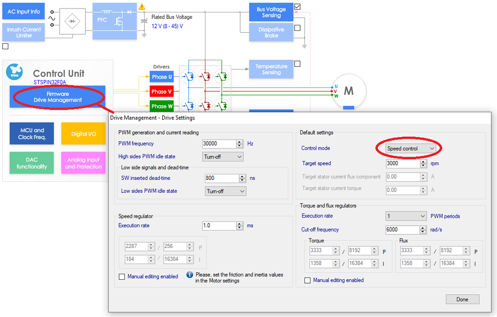

Hello @CFran.3​ ,
sorry but with "The EVALKIT-ROBOT-1 system only implements positioning" I meant the ready-to-use kit "board+motor+firmware".
You can use the board with Maxxon motor for free running but you have to modify the firmware properly.
I suggest to start from STSW-ROBOT-1 firmware example and open the project file (.stmcx file) in the ST Motor control Workbench.
Open the "Drive Management - Drive Settings" from "Firmware Drive Magament" options:
Here you can change the Control mode in "Speed control" and set the others application parameters according your requirements.
You can customize your application and save the project by clicking on the Save button.
This is the configuration file of parameters used and generate the code by clicking on "Generation" button.
In the generation windows you can set more parameters and after create the custom folder with your library code.
You can find more details on the UM2168 Using STM32 motor control workbench with STSPIN32F0 and STSPIN32F0A
