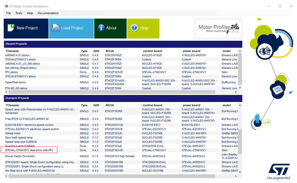

I'm searching evalboard with both dPFC and FOC (single motor control), 2-3kW at least.
I found STEVAL-CTM010V1. I'm looking for the source code to add some functionality - is it available to further development?
1 REPLY 1
Gigi
Ciao
You can get the FW downloading the X-CUBE-MCSDK
Be sure to download the version v5.4.8.
Open the example
STEVAL-CTM010V1 dual drive with PFC
And generate the code.
It should be a good staring point.
