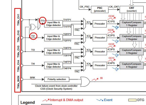

for a stepper based application I've to link the frequency that came from a quadrature encoder to the driving speed of a bipolar stepper motor. This board is equipped by a STM32F105RB processor, I've read inside the RM0008 (the reference manual) that the counter can be configured to act as Encoder Interface (§14.3.16 pag 329/1132). I some trouble to found the pins on this board related the timer that should be theoretically usedto perform the quadrature counter (if some are not directly accessible I'll wire up to perform the testing). From the reference manual these input are called TI1 and TI2 but at what physical pin are associated and where I can found this information?
[SOLVED]
Looking inside the RM0008 Reference Manual (Rev. 19) on page 294/1132 at the Figure 52 all became clear.

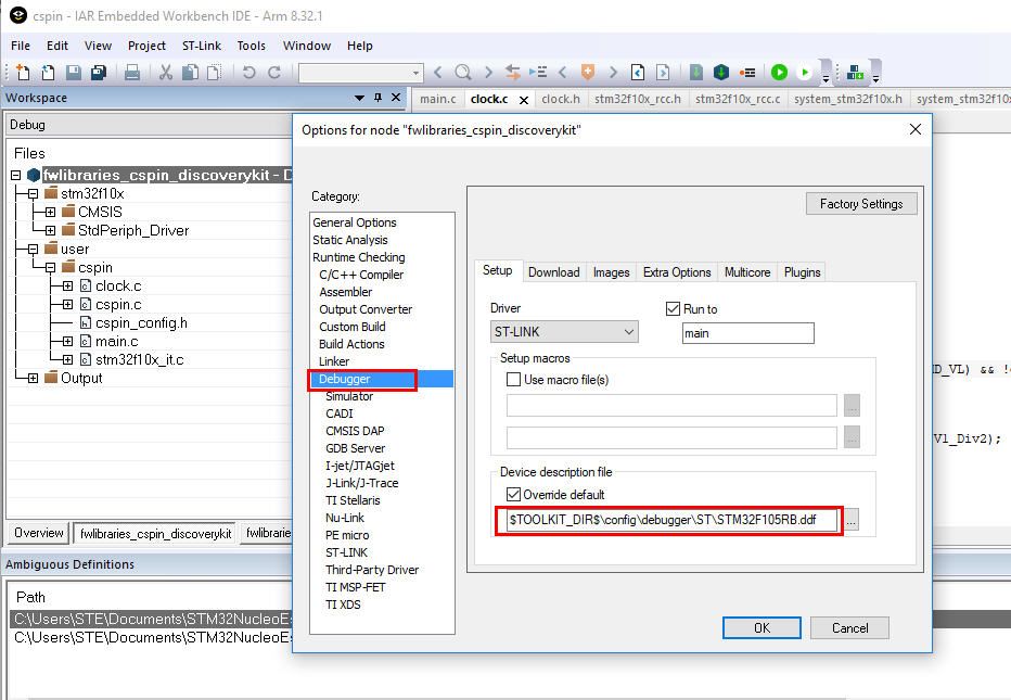

I've loaded the design but I've a missing file warning concerning a ddf file that I can't found into the library:
Fri Oct 26, 2018 18:43:54: Warning: The device description file: C:\Program Files (x86)\IAR Systems\Embedded Workbench 8.2\arm\config\debugger\ST\STM32F105xB.ddf defined on the Project->Options->Debugger page does not exist.
To solve this warning, from the project options (or alternatively right click on the project name and then choose Options...), under the Debugger entry you've to manually select the "STM32F105RB.ddf" file..

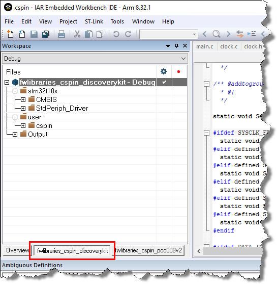

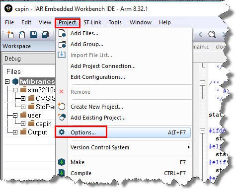

Hi all,
in order to know the board configurations that are set from the example design, inside the IAR Compiler, load the design Workspace cspin.eww from the path "user_motion\project\ewarm6\fwlibraries", then for the EVAL6480H-DISC board select the tab panel fwlibraries_cspin_discoverykit.

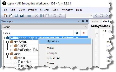

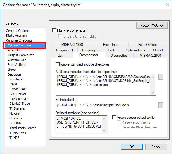

Now, according to the cspin readme.file (you can found it inside the user_motion\spin\ folder) we can take a look at the compiler preprocessor directives that was set inside the IAR Compiler for this demo project.
To do that simply select Project->Options... from the main menu:
the Project Options window will be open then select the C/C++ Compiler entry on the left and you are into the right place:

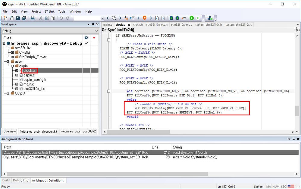

Now simply check that the options are the same as specificified inside the readme,txt file for the EVAL6480H-DISC board. The processor of this board is identified through the source code by the STM32F10X_CL definition.
Into the design file tree list on the left, choose the clock.c source and double click on it, then into the source code window on the right perform a search for the STM32F10X_CL label, you will found the following piece of code that will set the microcontroller frequency to 24 MHz starting from the external 8 MHz crystal clock soldered on the board (this conditional statements look for the STM32F10X_CL label that was already definited by means of the preprocessor directives).
Then, for this demo design, the internal clock frequency will be set to 24 MHz.
