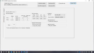

1) Problem related to STSW-STUSB002 GUI version 2.0.
The first problem is with the GUI version 2.0 as specified. When I made hardware connections as mentioned in the quick start document and I tried to connect the Nucleo- F072RB with the GUI 2.0, I got an error which says " The Parameter is Incorrect". and I'm unable to connect the hardware with the GUI 2.0.
I have resolved this issue by using the previous version ( STSW-STUSB002 GUI 1.09 ). So my hardware got detected in this version and I was able to program or write the NVM successfully. In the Connection Status of the GUI 1.09 it showed that " OK STUSB4500_L Detected (COM19), at address 0x28 (I2C bus 1)" sharing image below.
2) Problem related to the usage of the source device and selecting desired PDO's.
Currently I'm using the 65W mobile phone charger as the source device. I was not aware of the charging technology it was using. I was not able to switch the PDO profiles at the output. I was getting constant output 5V whereas the required is 12V. So if I'm not wrong the source must be USB PD technology support.
I need help on the available sources which I can use. And how can I select the desired PDO from configured PDO's in NVM to get the desired output 12V/2Amps.

2024-06-13 11:40 PM
Hello NBALL,
Sharing NVM data below for 15V PDO switching issue.
NVM data from Local:
0xC0: 0x00 0x00 0x00 0x00 0x00 0x00 0x00 0x00
0xC8: 0x10 0x60 0x9C 0x1C 0xF0 0x01 0x24 0xDF
0xD0: 0x72 0x40 0x0F 0x00 0x32 0x00 0xA0 0xF5
0xD8: 0x00 0x19 0xB4 0x5F 0xF5 0x0F 0xF5 0x00

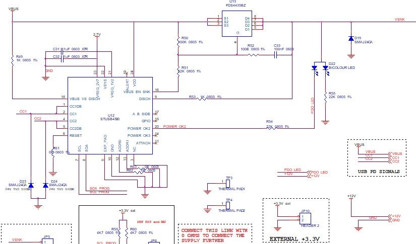

2024-06-20 1:08 AM
please provide a block diagram + vbus/vsink snapshot on scope on SPST toggle
Regards
Nathalie

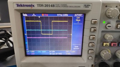

2024-06-20 2:28 AM - edited 2024-06-20 2:35 AM
Here are the waveforms for VSYNK (Pink) and Switch (Blue). Captured onn the event of abnormal operation.
Regards,
Ashutosh K.
2024-06-20 2:46 AM
It can be that switch closure generates undershoot on VBUS_VS_DISCH pin so that stusb4500 detaches.
If at same time CC pin goes to high level, it means it was overshoot (over voltage detected) otherwise, it is undershoot.
Having vbus_vs_disch pin voltage on scope might help
Best regards
Nathalie

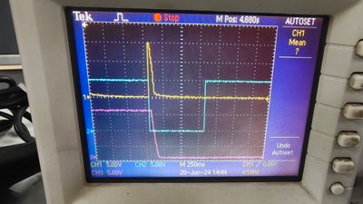

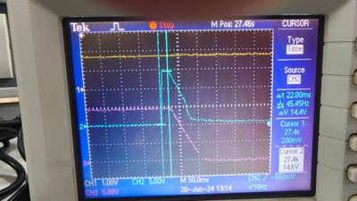

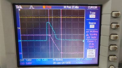

2024-06-20 4:18 AM
Hello NBALL,
Attaching Normal Operation and Abnormal Operation DSO shots.
***Normal Operation***
Yellow: Switch OFF and Switch ON condition
Blue: Vbus_Vs_Disch (constant +15V)
Pink: VSNK (+15V)
***Abnormal Operation***
Yellow: Switch ON condition (Not Made OFF)
Blue: Vbus_Vs_Disch (dropped for sometime)
Pink: VSNK (falled to 0)
What necessary steps must I take to avoid falling of the Vbus_Vs_Disch?
