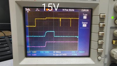

2024-06-06 5:11 AM
I'm getting CC communication and VSNK_ENB is also toggling from 0-5-0 right now for 15V and 20V selection.
Just VBUS is not setting to 15V and 20V. Attaching waveform below.
Channel 1: CC1 (Yellow)
Channel 2: VSNK_ENB (Blue)
Chaneel 3: VBUS (Pink)
How does in the VBUS parameters the Discharge time to 0V and Discharge time transition to lower PDO voltage affects the VBUS?
Regards,
Ashutosh K.
2024-06-06 6:41 AM
Hello
As already written without having message content I cannot debug further.
I observe result of a contract at 5V, this is just what I can say.
As mentioned in datasheet discharge parameters are to discharge VBUS on connector/vsink path during down transition or cable removal.
Best regards
Nathalie

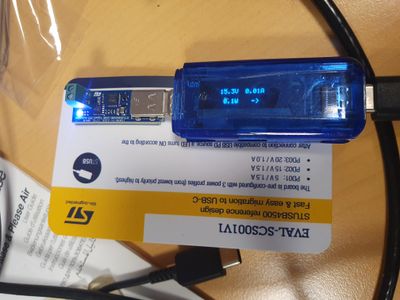

2024-06-06 11:53 PM
board out-of-the-box connected to 45W PD source
2024-06-06 11:56 PM - edited 2024-06-07 12:15 AM

2024-06-13 2:14 AM
Hello
I repeat: without protocol trace and full NVM content, no debug is possible.
Device makes a request on 5V: i have no clue why without having the traces. If source_cap are fitting with sink PDOs there is no reason to not take higher voltage.
As shown in picture, device is perfectly working and 15V/20V are 'default PDOs ' when we sell the chip.
Best regards
Nathalie
