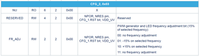

I have a question regarding the L9800 product (LS driver). The value of the CFG_2.FR_ADJ bit in "Table 12. Coefficient overview" differs from the value of the CFG_2.FR_ADJ bit in "Table 18. Register addressing space" in the datasheet. Could you please clarify which value is correct?
* Table 12. Coefficient overview
* Table 18. Register addressing space
