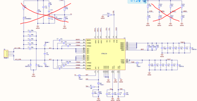

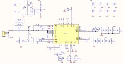

I'd love to add Wireless Charging to a project that is particularly space constrained!
I've found the WC Receiver STWLC38 which ticks a lot of boxes, but requires a lot of external components.
Has anybody used this successfully?
What is the minimum requirement for external components that could still function?
Reference Schematic Below:
2024-08-18 1:57 AM
Hi
If you use only rx feature and no need gpio, you can remove this
