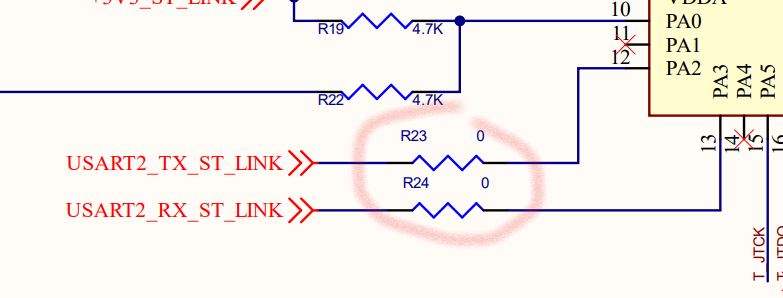

I'm trying to use the RX / TX interface on J5 on the B-G431B-ESC1.
​However, it looks like the ST-LINK daughterboard uses those pins too.
I​ know I can snap off the daughterboard, but I still want to be able to use the ST MCSDK tools, switching back and forth as needed.
Unfortunately, a HW ​is a pain as the lines are simply shared and there's no good solder pads on the ST-LINK daughterboard and the ESC board to make a jumper.
What would be even better though, is being able to get the stm32 103 chip on th​e daughterboard to simply tri-state those lines when they are not being used.
If​ I don't power the daughterboard, the MCU drags the lines down too far, if I power through USB and / or 12v on the main + - pins for the motor and battery elimination circuit, then the 103 is actively trying to drive those lines, making the ones on J5 useless.
Any ideas?​
Is there any way to do this?​

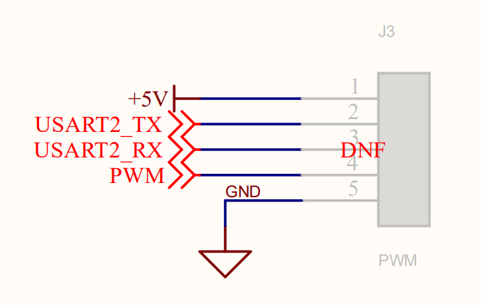

I'm looking the schematics of the board B-G431B-ESC1 but I see that the USART pin is mapped into J3 not in J5 (maybe is a typo).
Anyhow I think it is possible to unlink the USART pin of the main controller from the STLINK unsoldering these two resistors:

Yes, J3, J5/J6 are the power input pins on either side of J3.
I'll have to see if I can find where those resistors are on the board, I'm sure they're very tiny.

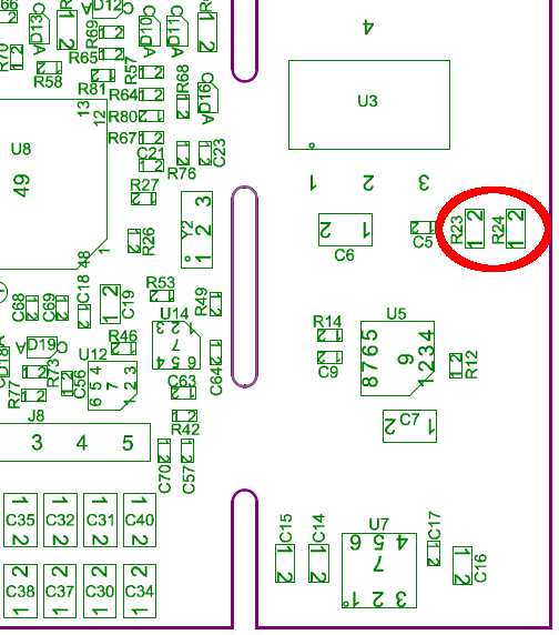

R23 and R24 are easily found on the bottom side of the daughterboard:
0693W00000UnZxfQAF.pngRegards
