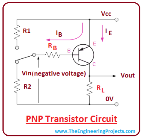

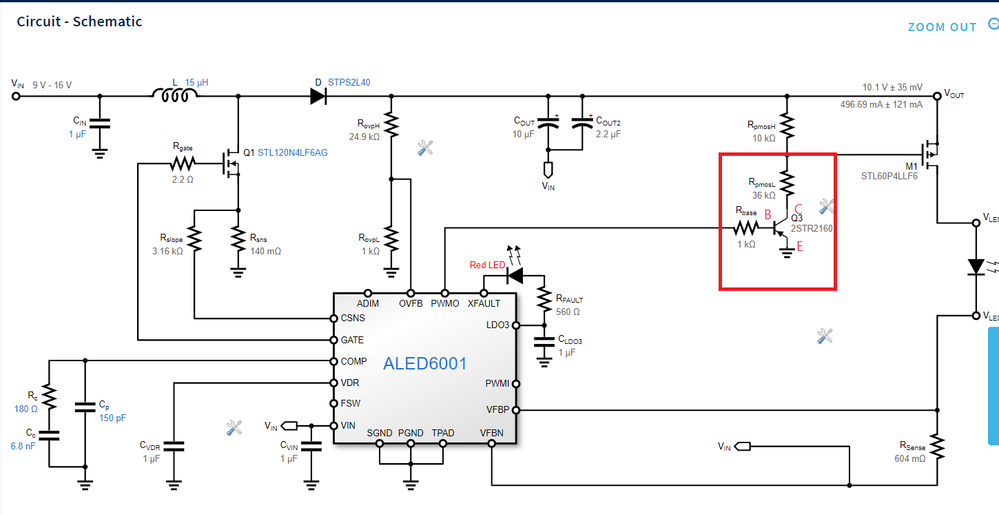

Hi Sir,
ALED6001 eDesign show BJT is as the red rectangle.
0693W00000ANG4eQAH.pngHowever, most PNP BJT is show as below picture.
0693W00000ANG5IQAX.pngI search some data, they show exchanging BJT's E and C, BJT can work.
However, the hfe will decrease and the BJT cannot afford high voltage.
Below example is for NPN.
https://www.rohm.com/electronics-basics/transistors/understanding-transistors
Why eDesign exchange E and C?
Thank you.

Please don't be confused by the different types of BJT: the eDesignSuite proposes a npn BJT but you are talking about a pnp.
Regards
/Peter
