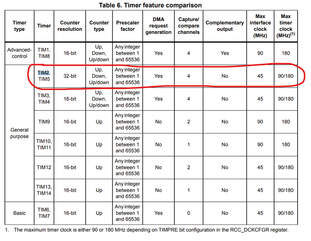

Hello @Danish​
Thank you for your response. Before using the timer 2, I did check the manual about timer in the datasheet as below:
0693W00000WId0JQAT.pngAnd timer 2 has a counter of 32-bit.
That is why I got confused a bit.​

For the question "How strongly do you know that htim2 refers to TIM2?": it is in the initialization of timer 2. htim2 is just a name. And in the initialization function, the instance of htim2 is TIM2 (htim2.Instance = TIM2;)
As for your other suggestion, I will bear that in mind and check it. I think it is also about the maximum counter or Auto Reload Register (ARR).
I will update more.
The ARR value is the issue here. Earlier, I used the TIM10 and its maximum value is only 16 bits. Later I changed to TIM2 and its maximum value is 32 bits but I forgot to set the Period (ARR) value so the counter rolled over when it reached 16-bit. As I set the Period (ARR) value to the maximum possible (32 bits), it returned the values that I want.
