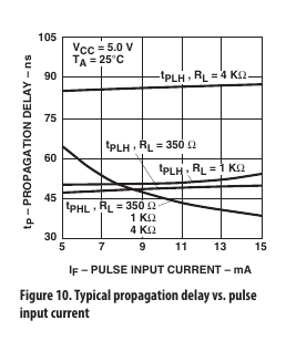

Couldn't see a definitive answer in the datasheet - What is the source \ sink capability of a USART TX \ RTS pin?
The nearest answer I could find was page 128 of DS13313 Rev 5 -
"GPIOs (general purpose input/outputs) can sink or source up to ±8 mA, and sink or source up to ±20 mA"
but there isn't anything specifically that mentions alternate function pin capability.
Can TX and RTS pins directly source or sink an LED via a 220 Ohm resistor (that would be ~15mA each) ?
I'm thinking I may have to add external drives like high side MOSFETs otherwise.
Thanks.

Sorry, 180mA was my estimated max for the entire PCB with a little bit of added margin, but I can crank down the 6 LEDs a bit (they are Optos) before edges become an issue.
I forgot to check the total current sunk for the alternative H723 MCU - luckily its 20mA higher than a F723 and not less.
I'll breadboard an Opto to a UART TX\RTS to verify that area before I finalize the PCB.

Optos don't light up rooms unless you made a serious wiring mistake.
15mA is the upper limit but I probably can crank it down to 10mA without impacting max baud rate...
