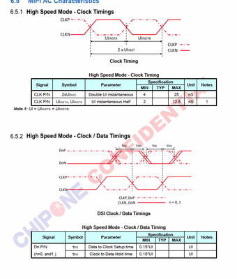

Hello everyone,
I want to use a C05300 based display with DSI.
I can write and read in LP mode, but not in HS mode. I guess it's a timing problem.
As seen from datasheet,
UI should be more than 2ns, so I use a 500MHz bit clock.
I use 24 bit data format to send data over DSI, so Pixel Clk = 480 x 2 / 24 = 40 MHz.
I there something I miss?
Best answer by CDecouen
Hi there, it seems that despite the datasheet specify there are two data lanes, only one is used... Unless there is something else to setup.

CDecouenAuthorBest answer
September 8, 2025
September 9, 2025
Hello @CDecouen
I recommend you have a look at this AN4860 Application note related to DSI Host on STM32 MCUs, providing guidelines and practical examples on how to configure the DSI Host depending on the operating mode.
Check the DSI PHY timings and DSI config on HS mode are compliant with the specification provided in the AN4860.
Can you try the DSI example in STM32CubeF4 firmware and update it according to your need. For example on : STM32CubeF4/Projects/STM32469I_EVAL/Examples/LCD_DSI at master · STMicroelectronics/STM32CubeF4 · GitHub

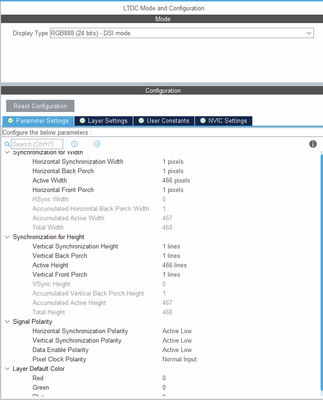

CDecouenAuthor
September 29, 2025
Hi @HareshPrajapati, here is the configuration I use for LTDC

CDecouenAuthor
September 29, 2025
I have 0xFF  for register #0x63
column and row start depends on display manufacturer. I use 00,06,01,D7 for columns and same as you for rows.
Hope this help, tuning those display parameters is very tricky
