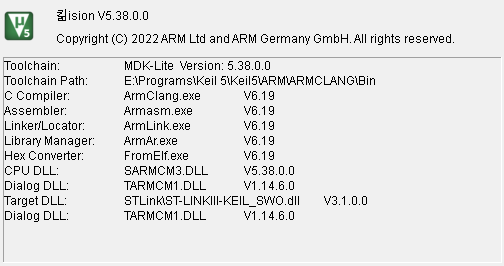

I am writing code for the STM32F031K6T6 MCU using the Keil uVision. The IDE information is shown in the image below:0693W00000YAKYEQA5.png

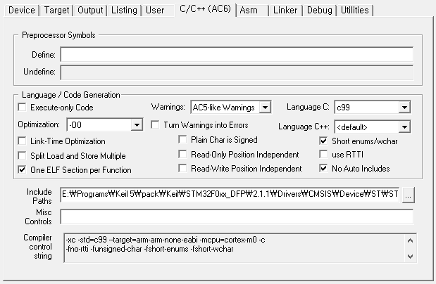

The C/C++ options for Target are configured as shown here:

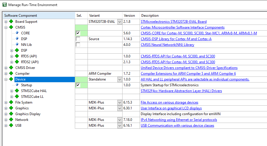

I started a new project, selected the chip, and configured the run-time environment as below:

> SysTick_init(47);
This floods the mcu with systick interrupts. The execution of systick ISR when using -O0 takes more than 48 system ticks.
Leave the systick to run up to its maximum, and base the loopdelay on reading its value.
Additionally, you have to qualify usDelay as volatile.

Absolutely correct. I just replaced the highlighted line with:
SysTick_init(479);
And all went well.
That explains why the code worked with the STM32F429ZI: that chip can run with a frequency of up to 180 MHz. It is not possible to enter and leave the ISR at the same speed in the SMT32F031. Of course!
Thank you and thanks for the additional tip about the volatile keyword.
